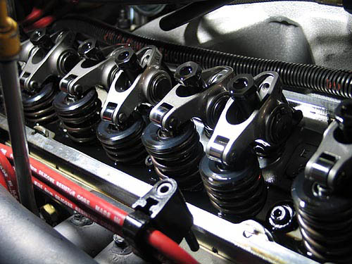

No problems yet with mine, AFR 195 and Pro Mag Rollers. Been running fine since November last year.

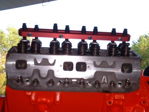

Oh, only advise I can truely attest too...dont buy the "long" poly locks when you opt to install a stud girdle. Guy I ordered the girdle from ordered the long nuts thinking that's what it needed with the girdle to work. The "long" studs are for BBC applications
Attached Thumbnails AFR and Pro Mag Rollor Rockers-bte-seqoia-poly-locks

Actually if you look at cartmans pic real close you can see the studs are slightly too short. Look at how far down the locking allen head is in the poly lock. If the studs the right length the allen head will be nearly flush with the top of the lock. We ran the stock afr studs for several months with no problems. Then one broke. When we took a closer look, and the polylocks were only grabbing about 4 threads. We used aftermarket tall centerbolt valve covers and had no problem with them.
