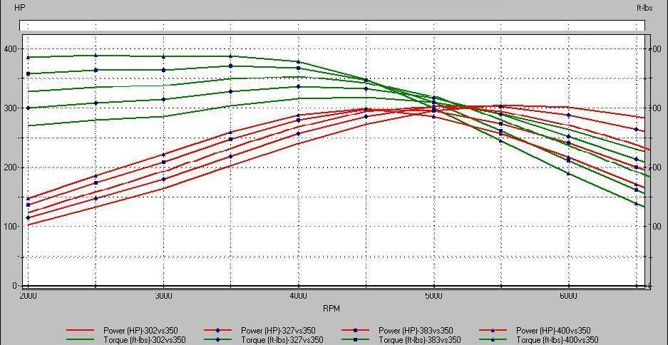

I have posted this in the past, and luckily (spelling?) I still have it. It's a clear explanation of why a 350 makes more overall power than a 327 everywhere else except above 6,500 RPM.
That was using the same cam, same heads, same compression ratio, etc. on DD2000.

Here's another Combo of what everyone had requested. Nothing else is changed except the bore and stroke of each engine.
Just to give you an idea in case it's difficult to see.
The top green line is the 400 torque curve.
The next green line is the 383
Next is the 350
Next the 327
Next the 302
Can you guess what order the red lines are in?
Then above ~ 5,000 RPM is where the opposite occurs.
The top red line is the 302, the next is the 327, etc. etc.
Does this help everyone understand why there's no replacement for displacement? Unless you're only really looking to make more HP above ~5,000 RPM on an otherwise mild-to-slightly aggressive engine (or "dare to be different), there's no reason to use an engine that's smaller or has less stroke.

And here are the specs that I used for all the engines. As I said, nothing was changed, other than the bore and stroke of each engine.
And before anyone asks "why did you use that cam?" or "that compression?"... because that was pretty much all DD2000 Default settings.

As you can see from the graphs, engine size does not effect the peak hp that an engine combo makes, its the components. With everything the same except for engine size, peak hp is the same. This does not occur for torque though, bigger engine = more torque, smaller, less.

Look at the graphs with the same components all the engines of differring sizes have the same peak hp potentional. Of course the smaller the engine the more it will have to be revved and the more gas it will use. Also the smaller engines will use more gas because they are not as efficient and lower cruise rpms.

I think that the graphs that have been posted create a strong argument for strokers, but at the same time they create an argument in favor of short stroke engines. If you happen to be someone who wants more power above peak TQ, at the expense of some bottom end.
Anyone will have to admit that in the graphs that are displayed, the 302 has a pretty flat TQ curve.
But on the other hand, it could be argued that camshaft selection could potentially play a role in extending the power curve where it falls off too early on the larger engines. For example the TQ curve for the 400 with the 236*@.050 cam has the same shape as the curve of a 350 with a 218*@.050 duration cam, only about 50 lb/ft stronger overall. And on and on...
So where that actually leaves you is... If you aren't into playing keeping up with the SBC Jonses and you want an engine that revs higher at the expense of some low end TQ, you can do a destroked 400.

the enjoyment of redlining at 7.5k with a aftermarket crank 415 still pulling strong > the enjoyment of redlining at 7k with a stock crank destroked 400.

"Anyone will have to admit that in the graphs that are displayed, the 302 has a pretty flat TQ curve.
But on the other hand, it could be argued that camshaft selection could potentially play a role in extending the power curve where it falls off too early on the larger engines. For example the TQ curve for the 400 with the 236*@.050 cam has the same shape as the curve of a 350 with a 218*@.050 duration cam, only about 50 lb/ft stronger overall. And on and on... "
Correct here is a comparison with the larger motors getting larger cams 327-400. XR274-XR292

As you can clearly see the 400 still makes way more torque and way more hp. I'd go with the smallest engine possible if it was me, i hate going fast.

From your calculations could you please tell me the rpms for the maximum safe piston speed for a 3.75" stroke and 3.0" stroke. I believe its something like 5000fps. I could do the calculations really quick and easy but i'm leaving now.

Yes the numbers are off but it is a very good tool for comparing builds. Infact thats all it really good for.

DD2000 is
dd2000 said my engine will make 524 hp it only made 450 hp on the dyno.
DD2000 is
