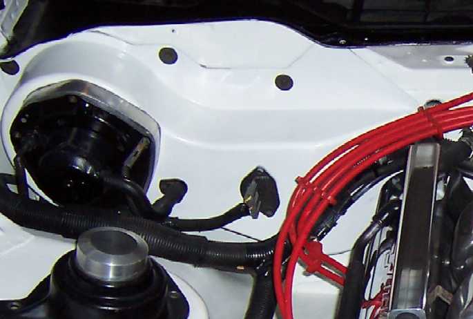

I made a 1 inch spacer out of billet aluminum....you could try doing something like that.
Attached Thumbnails a/c delete box question-000_0466ac.jpg
