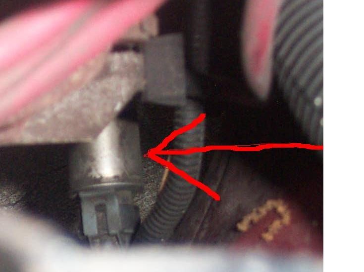

is this it
is this the o2 sensor this pictue is to the rear and down a foot or so on drivers side the arrow points towards the front of car

nope thats not it!follow the ex. manifold to the connection of the drivers side y-pipe,at this point you will see,feel the o2 sensor it has one wire coming from the dr.side motor mount to the sensor

ok this must be it then
this does have only one wire and point kind of forward at a slight angle towards the fender----and will replacing this fix the code 44 problem ??

thats it!it looks relatively new but it can still be bad,if the o2 sensor has been bad long enough it can kill the map sensor,dont forget to disconnect the battery before you do your work or the problem may still exist in the ecm.
