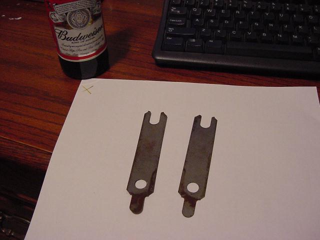

You will probably need 2 or 3 shims to get it off. The right way to shim is to pull gear out and have a .035" to .50" clearance (i.e. fat paper clip). I would put in 2 to start and see where you are at. If it starts but makes noise, add another. My old TCI mini-starter made a lot of noise but started engine, 2 shims fixed it. Hope this helps.

where can i get shims? i know this is a dumb question
Old Jan 15, 2005 | 10:15 PM
Lo-tec's Avatar
Joined: Jan 2005
Posts: 1,768
From: Gambrills, Md
Car: clapped out 84Z
Engine: 355 efi roller
Transmission: tremec TKO
On sunday, try local auto parts store. Can definitely get them at the dealer, but call first because if special order come in box of 20.
When you go to install, remove outer bolt.
Loosen inner bolt.
Insert shim(s).
Insert outer bolt, tighten both, and see what happens.
Good luck!!

ok i went out and got shims after chruch. I then shimed it .015 at a time. i started with .015 didnt work, .03 didnt work, .045 dindnt work, out to .60 and didnt work, out to .75 didnt work from their i stioped b/c thats way to far form what the instructions say that .02 to .06 is what you want. So what could it be. I noticed that when i turn the key off of crank i get this weired murmering sound coming form something around the engine.
