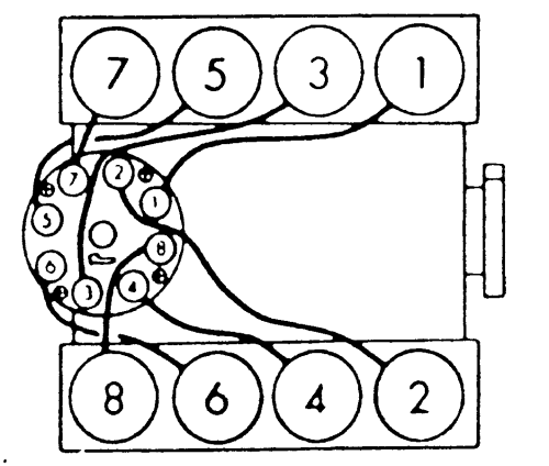

18436572 clockwise

Visual.
Attached Thumbnails Engine running sloppy after header install-chevyfire.gif
