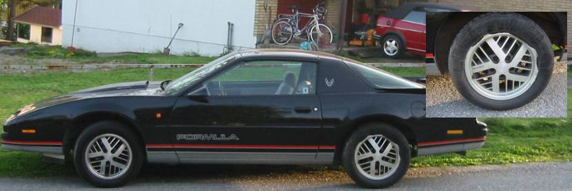

I agree with IHI on this one, I didn't feel any vibration at all, even with that cracked rim! I drove it home that way, kept it a bit low though, about 40 mp/h or so.
The only reason I found out that the axle was bendt, was because I mounted on a really wide rim, 11,5 inches, and peeped out the window to see how close it was to the fenderlip. That's when I spotted it.
