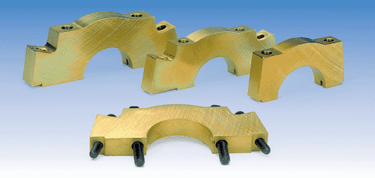

A pic is worth at least 1000 words.
Notice how the 2 outward bolts aren't parallel to the 2 inner ones.
The caps cost around $200, and installation is another $250-250.
The best block (out of small blocks anyway) is a 2-bolt 400 block.

RB83L69....what brand are those caps you pictured? I am thinking about going with splayed mains when I build my stroker and probably will for the strength.

Milodon

BTW - If you have the correct drill bushings, or a decent mill, you can drill/tap the outer bolts easily. The trick is going to be align boring the block if your mill doesn't have a really low knee and one long-ashed boring bar.

I hope your machinist doesn't bore it .30 over, you won't have any cylinders left if he does. I put the splayed caps on a friends engine once, but I used a Bridgeport milling machine to do it correctly, it was pretty easy to do if you have the CORRECT equipment. He then took it to a shop that had a align-boring machine to have it finished.
