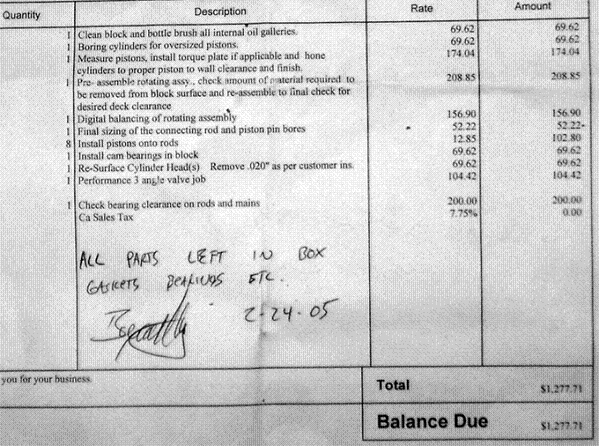

Just wanted to know what you guys think about the prices, there is one thing that is not one there, and that is a port and polish for $400.
The shop is a high-performance shop, so it's not like it's a muffler slash everything mom-and pop kinda place.
Thanks,
-SuperchargedRS

Everything on there is more than what my shop charges. Mine does the cam bearings + freeze plugs for $40. But if their as good as you say, I suppose its not too bad. Mine will make clearance, put new bearings and assemble it for $450.

I love how a 3 angle valve job is still considered "performance".

seems high But did not have the shop assemble the lower end and install. I see you did so labor is coming into play here. SOme stuff listed is lower than my shop but mostof it is higher. I am not getting a deal from the shop either ... ******

200 bucks to check there own work on the clearances? I don't see it listed, but did they turn the crank? Regardless, they did resize the rods...why the heck would they charge you another 200 to check thier own work?
I see the invoice in from Ca., where abouts?

I agree with 8Mike9. Everything looks fine except the 200 for checking the clearances, How much will they charge for sweeping up the shavings from machine work?

Yea, I thought that looked a little funney, I will call them today and get that...fixed.
