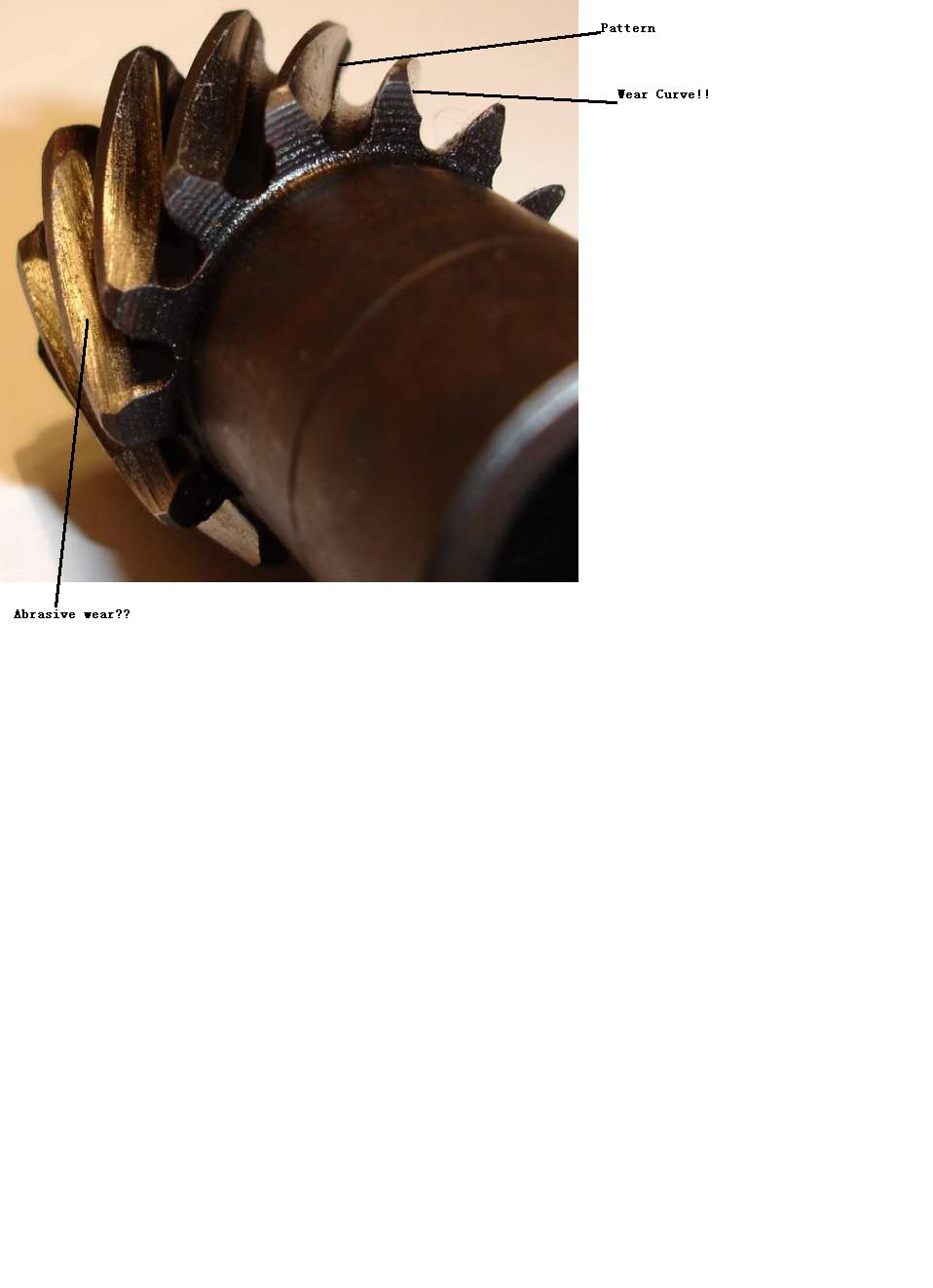

check it out guys, comments much much much appreciated! (I am trying to paste a picture, If I make a mistake I'll try again) Zoom in to really see the 7 megapix detail.
Yeah, My gear was worse than that!!! The guys was using a bronze gear and bought a new dist. He swapped the bronze gear out for the old wore one. Guess who got the wore gear!!
But yeah, mine was worse. I should have known better than try to use it in the first place.

Oh yeah, with a ridge worn in it like that it's toast. There should be a smooth, shiny wear pattern witnessing contact with the distributor gear, but definitely not a ridge of any kind.
