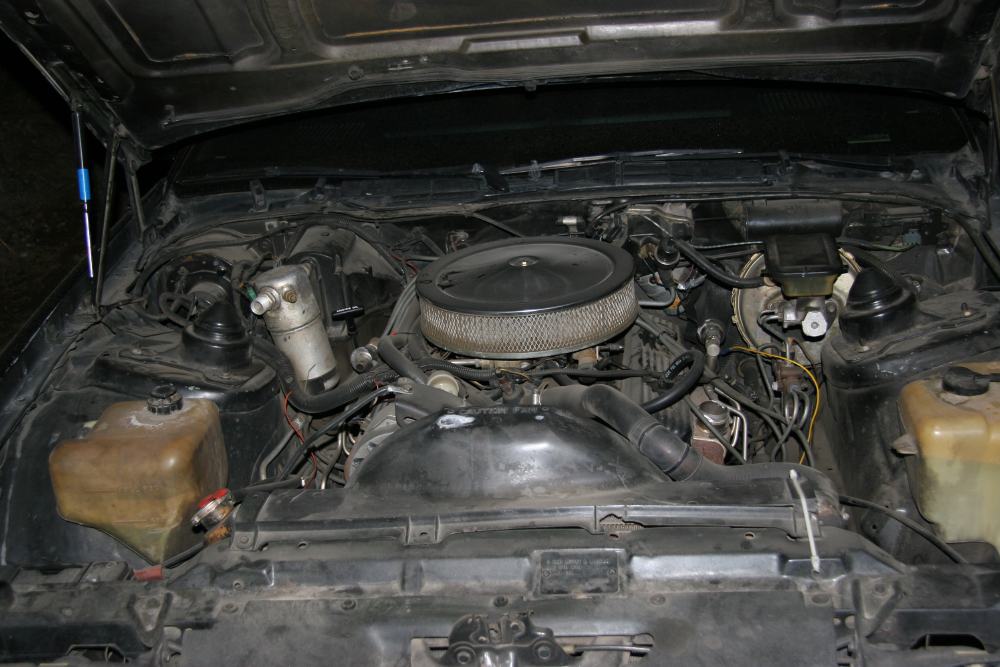

Ok, here's the engine pic.. Just reminds me I have a lot more to clean...

Man,all you need is to clean the engine and int,and youll have one sweet ride.And get new black carpet.Hows your headliner?

LG4 in there, carb... nice car all around. way better than mine was

Headliner is great. It's either very very new or was never damaged, near perfect...
so LG4, non crossfire, right?
Correct

yep, looks like an lg4, which is the low output 305. not crossfire. what are you looking to do with the car? everyday driver with occasional trips to the track? weekly trips to the track? more into auto-cross? or just a badass street car that never sees any track time? regardless, get you some headers first. a set of hooker p/n 2055's will do very well. a full 3" catback with a high flow cat. what are the emissions laws in you area? if there aren't any, then you can delete the smog equipment. are you ever planning to replace that motor with something bigger? do you want to stay carbed or go to fuel injection?
sorry, i am a go-fast guy and appearance stuff always comes last to me. but i must say, that is one sharp car!

I see you have tried to remove the A/C, well you should get rid of the whole module against the firewall, it would look more open in the engine bay if you did that. Especially if it was all nice and clean

Someone has been into the engine. Those are centerbolt valve covers and will not fit OEM 1982 heads, late 86+ heads on that engine. Your going to need to find theine casting number on the engine before you start dreaming of a HP machine. SFC's will have to be custom built to fit clear your 82 exh system assuming its factory. A good set of headers and a high flow cat will make a nice improvment and should be the first mod you do.
Find the engine casting number and let us know.

agh, I cant tell if they're actually centerbolts or perimeter valve covers from the picture. How can you tell SSC? They look like my '86 LG4's valve covers, but I trust your word... which side can you best see the centerbolt indents?
Sure looks stock to me atleast.... and he tried to delete AC

You can see the center bolts circled in red.
Is that an engine oil dipstick in the tranny tube?
Simple Green is your friend.

Nope, the oil dipstick is on the back area... Look at the chrome, then look at the 10:00 position.. If you look super close, you can see the white lettering...
Simple green you say? I'm guesing good cleaner? I'll have to get some of that.. I'd like the engine area to look as good as the exterior too..

I see the holes now They were sorta hidden by hoses heh.
Go to www.mortec.com so you can find out what motor was installed in your car, or if someone just did a head swap at one point.

I've started work on the engine compartment. I've cleaned up the only shiny part in it (air filter top), but haven't started anything else.. That's for tommorrow and saturday. HAs anybody here ever used castrol SUperclean? It cleans really well, but it's also extremely strong.. SHould I use this, or some other cleaner? The soap I have now is mostly a good exterior cleaner.. IS simple green the best dirt and grime remover, along with gunk thats in an engine compartment?
You can't see the indents, but you can count the ribbing, there's no breaks in the ribbing for the bolt holes, and the artifacts circled in red are sitting on a rib. My 88' L98 valve covers have 7 ribs, and the 3 ribs in the center aren't continuous where the bolts are, other wise they wouldn't seal very well.
Justin can tells us whether the bolts are on top, or on the perimeter. Justin, Hey!, where's Justin?

Justin,
After you get the engine cleaned up, get yourself a new overflow and washer fluid bottle. The was you have are looking pretty bad. Cheap to replace and makes things look a lot better.
I'm thinking they are the bolts.. But then again, a picture is worth far more than someone who doesn't know what you are really talking about's opinion.. therefore, a pic, at the points in which the red circles were drawn by someone else.. I think it'l answer your question...
And yes, I hate the steering wheel too...
That's a good idea aout the washer/overflow bottles, mine do look really bad.
You guys do know what you are talking about!

And that solves the almost-mystery of whether it's perimeter valve covers or centerbolt.
Did you nab the casting numbers off the block yet Justin?
