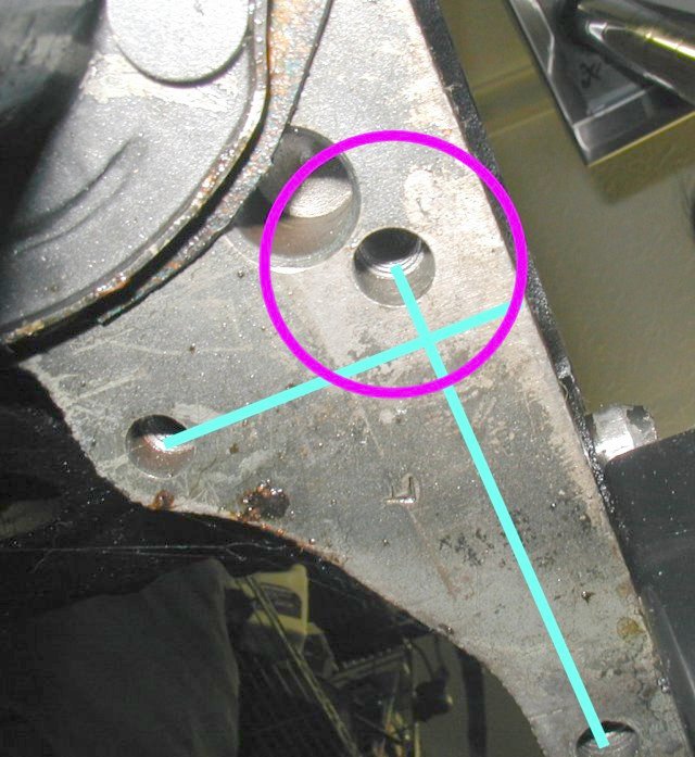

This pic shows a block that I drilled (this one is a 400). The intersection of the cyan lines shows how far off the location of the existing hole is from where it needs to be. Look inside your starter and get yourself a good laugh at the expense of the people who don't know what they're talking about when they tell you about some starter "ought to" work.
Attached Thumbnails Starter question..............-c-old-d-drive

In the picture is the new hole drilled? I assume that the circled hole is the new hole that is needed? Or is the new hole not drilled in the picture and will be drilled at the intersection of the lines?

All holes are drilled in the picture... The intersecting line illustrates why you need the circled hole.
