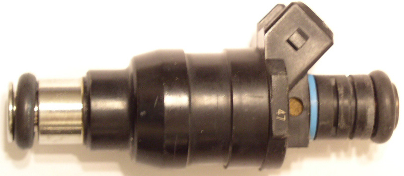

On a side note, and not to hijack... can anyone identify these injectors for me? I've looked hi-n-lo on the net as well as asked several local mechanics and friends, with no luck. These were included in a car purchase but the guy I bought them from had no clue as to what they are... other than 47 lb injectors that were on the 91 Z28 when he bought it... which were WAY too big for the stock TPI intake system.
Thanx to ANYone who can help....
Jim

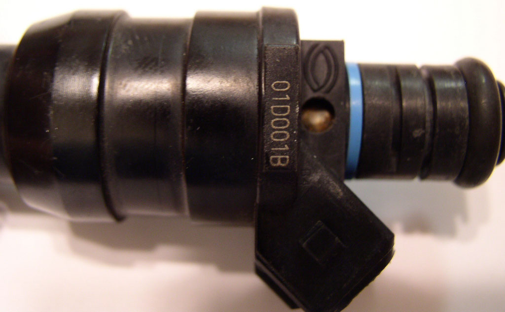

.. and another
Here's another shot
Jim
