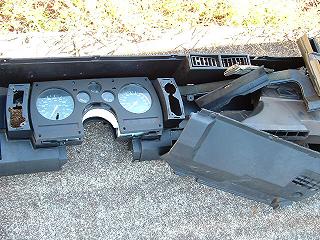

If I had saved the pictures of it, I could show you what I'm talkng about, as I have done some fiddling around with dashboards on F-bodies before. This is just some of the junk I pulled out of a beater Camaro once, in an attempt to fix up a Firebird. Don't try this at home.
