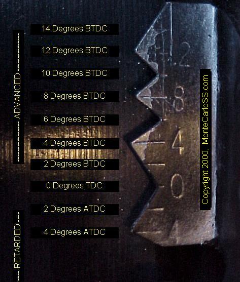

If you need a little help on timing, here is a picture I've stolen from another website, an invaluable picture:

alright so jsut keep it at idle and plug the vaccum advance going to the dist? now what about the other timing figures, do those come when you modify the curves from the distributer weights adn springs? how do they work exactly

Unless you've modified the distributor with something like the Crane kit that Sonix mentioned, there's nothing you can do about the other values, so you might as well ignore them.
The actual advance you have at any time is called total advance, or total timing. It's a combination of the initial timing, plus the advance you get from the centrifugal advance mechanism, plus the advance from the vacuum advance mechanism.
The centrifugal advance mechanism uses a pair of weights the fly out against the tension of a couple of springs, which advances the timing as engine speed increases. By varying the weight and shape of the weights, and the tension of the springs, you can change how much centrifugal advance there is, and how soon it comes in. Usually there should be able 34 degrees or so of centrifugal advance plus initial advance by around 2800 RPM or so. That's why some people set their timing with the engine spinning at 3000 RPM.
Vacuum advance increases when the load on the engine is low at part throttle (since manifold vacuum is somewhat related to engine load) and disappears completely at WOT. The amount and rate of vacuum advance needed varies depending on the car, and so it's usually set experimentally.
