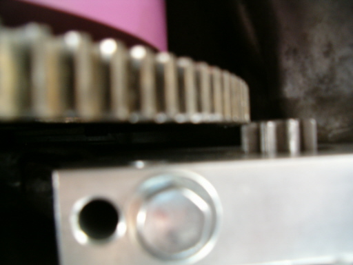

Heres the pic

Try adding another shim. Did you pry out the bendix and check the side gap?

That's not his problem... and the shims that go between the starter and the block, have nothing to do with it, and won't fix it.
He's got a Hitachi starter; where you put round shims kind of like rear end carrier shims, to space the whole motor off of the aluminum mounting block.
Nippondenso starters don't have that hassle. They retract farther in the first place.
I'd suggest one of those instead of the Hitachi one.

A picture is worth a thousand words. You need to place a shim between the starter motor and the aluminum mounting plate. That will pull the bendix back away from the flexplate. A small washer between each will do the trick unless your starter came with additional shims. This is not uncommon.
I had trouble getting a correct engagement between my CSI mini starter and my 400 block. I actually had to mill off 1/16" of material off to bring the starter closer to the block. All is good now!
