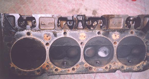

Old May 30, 2005 | 08:07 PM
kamaroirock's Avatar
Joined: Jul 2003
Posts: 219
From: N.Y.
Car: 02 z28, 03 wrangler sport
Engine: ls1, 4.0L
Transmission: t56, 4speed auto
pictures
Old May 30, 2005 | 08:09 PM

Old May 30, 2005 | 08:20 PM
Token's Avatar
Joined: May 2003
Posts: 1,995
From: Toledo, OH
Car: 1992 Firebird
Engine: forged 357
Transmission: 700r4, 2200-2400 stall, vette servo
Axle/Gears: stock pegleg 2.73 drum (temp)
yes, that's a telltale sign of burnt coolant. At least it's a very simple fix. How did the head gaskets look? My guess is still the intake manifild was leaking.

Originally posted by kamaroirock
head gaskets looked almost new.
Your intake valve is shiny and new I noticed... This indicates that the leak is probably coming in from above it... General correlation, but not accurate. I'm 90% sure it's an intake leak. Just inspect the heads for anything unusual and put it back together with new gaskets and use plenty of RTV.
UPON CLOSER INSPECTION I see rust all around the perimeter of the cylinder, as well as donw the side of it. I can tell you right now that is not supposed to happen
When you re-assemble it be sure to use RTV on the head bolts as well as around all coolant/air passages on the intake gaskets.

Originally posted by Token
Your intake valve is shiny and new I noticed....
it looks that way in the picture but up close its more like a white powder build up i was guessing from detionation or something.
i cant believe the previous owner didnt put it together with any type of adhesive on the gaskets. hope fully thats all it is and she'll be back running again.
