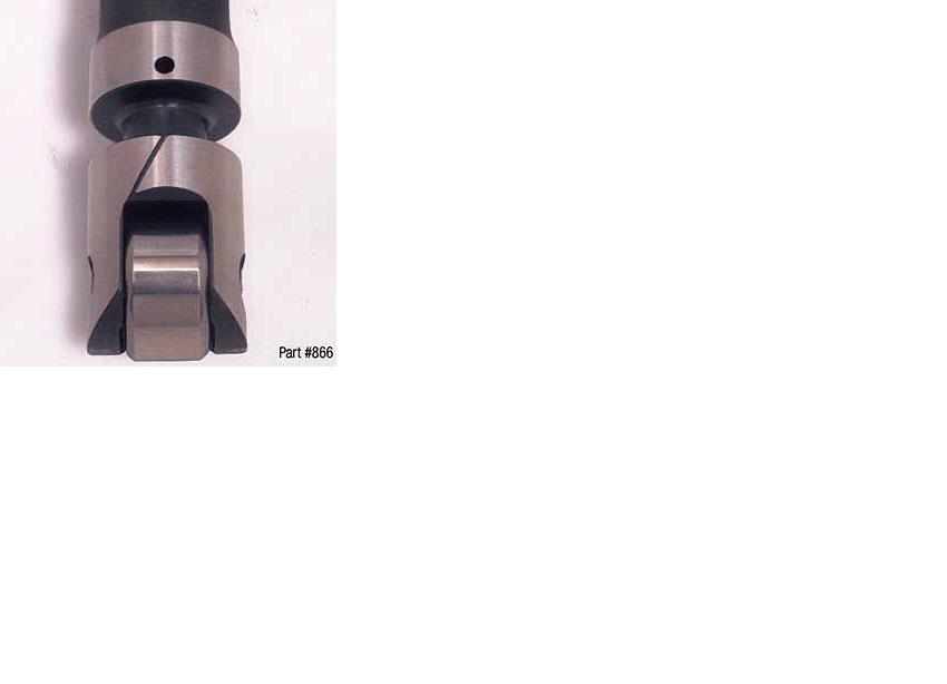

The endurex where too expensive,If i use a small file i can probably make my own oil groove what do you think guys?

It's doubtful weather you would be able to file it since it is more than likely hardened. You could use a dremel with a small cut-off wheel and cut some grooves in like the Endure-X lifters. Cut the groove at a similar angle - this helps to direct oil towards the critical inner axle/bearing area. Keep the groove depth and width small, so it doesn't bleed off too much oil pressure.
RB83L69, that tool is meant to increase lubrication for a flat tappet cam/lifters, and wouldn't help to lube the roller lifter's bearing.

The tool makes essentially the same groove as what you see on that lifter. Yes, it's not the greatest thing for oiling the bearings; but it's better than nothing.
