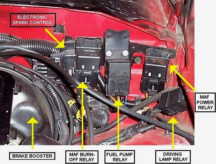

The burnoff relay is on the firewall, drivers side, alongside the fuel pump relay, ESC module, and whatever that third relay does.
I sold my '88 Helms when I did the LS1 swap so I'm not much help on which one of the three relays you're after, but I know it's not the oddball one...that's the fuel pump.
The other two relays are same part and you can (if I recall right) just swap them to see if the problem follows the relay.

Depends, they will all resct a little differently. Below is Vader's car with the relays labled (similar to later years, it's a chicken, not a maro). Some f/p relays are the same as the MAF ones on some years, can't really recall which ones though. They only run ~$13.00 so it's no big deal to go grab one to swap out. Have you pulled any codes yet?

Thanks alot guys, the problem was the burn off relay, and it had a cut wire going to it (DAMN Mice)
