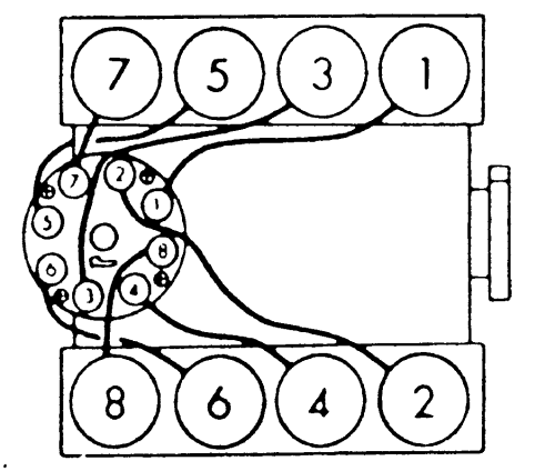

1-8-4-3-6-5-7-2
#1 can be where ever you want to put it depending on how the distributor is installed but since you never pulled the distributor, #1 should be roughly at the front driver side of the cap.
Rotation is clockwise. Just double check #5 and #7 plug wires to make sure they're going to the proper plugs.

Thanks for all the help guys, like I said before you guys kick butt, the problem was in one of the spark plugs, and the wires where mixed up #1 and 3, stupid me!!! Well thanks again.
