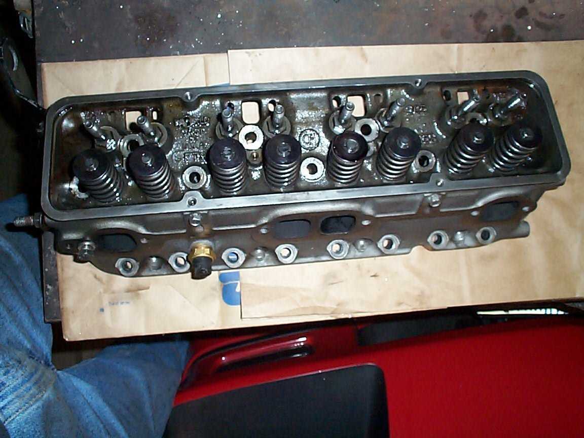

As a double-check, you'll want to be certain the rockers are fairly well centered over the valve stems.
I found one clear photo of the assembled S/R heads that I had, and it's fairly obvious how the valves are slightly splayed. It is easy to envision how that would affect the appearance of the rockers once installed.

perfect photo
That photo is worth much more than 1000 words. Thanks very much. Your remark about the rocker arms being centered over the stem tips is well taken. That was what I was most worried about, but I scored some ISKY adjustable guideplates early on in my parts "collection" phase so that shouldn't be a problem. I knew I wasn't crazy, it just seemed like a lot of others thought I was. Anyways, thanks again.
