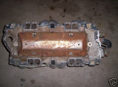

found a crap picture on ebay just to show you guys what I'm talking about.

That's just a heat shield. I'll leave it up to you if you think you need it.
