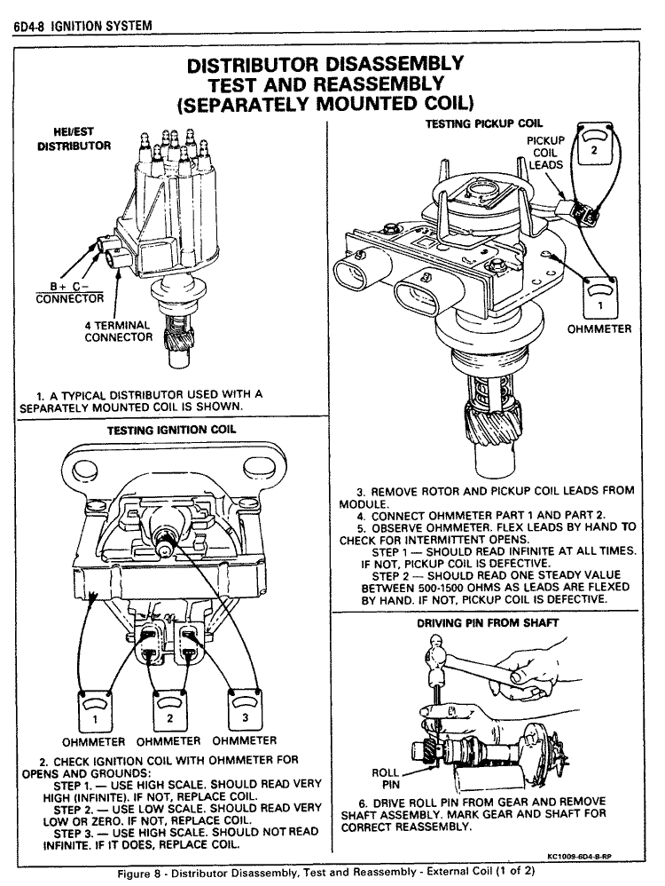

Should test your pickup coil, and ignition module. Either can be notorious for giving some weird starting/running conditions.
I know that this pic is for a V6 distributor, but the same principles apply in the same areas. All you'll need is a voltometer.
