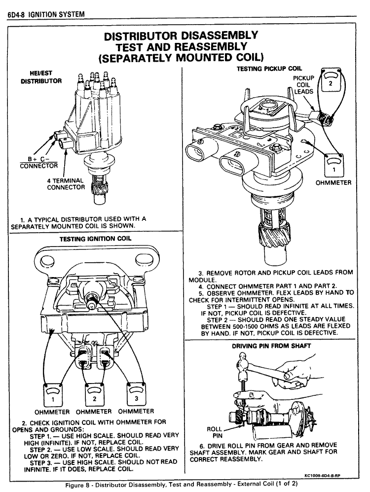

I know that this picture is from a V6 distributor, but if you find the same spots on your V8's distributor, the readings should be the same deal (sorry I dont have a picture of a V8's for this)

when testing this does it make a difference if my car has an in cap coil?

i think its my coil... the pick up coil tested fine but when i checked the coil on step 2 i got a 1 on the low scale.

To answer your question, no it shouldnt matter whether it's in cap or not. as long as you test the same grounds and such
Sounds like you may have found your culprit though. Good job
