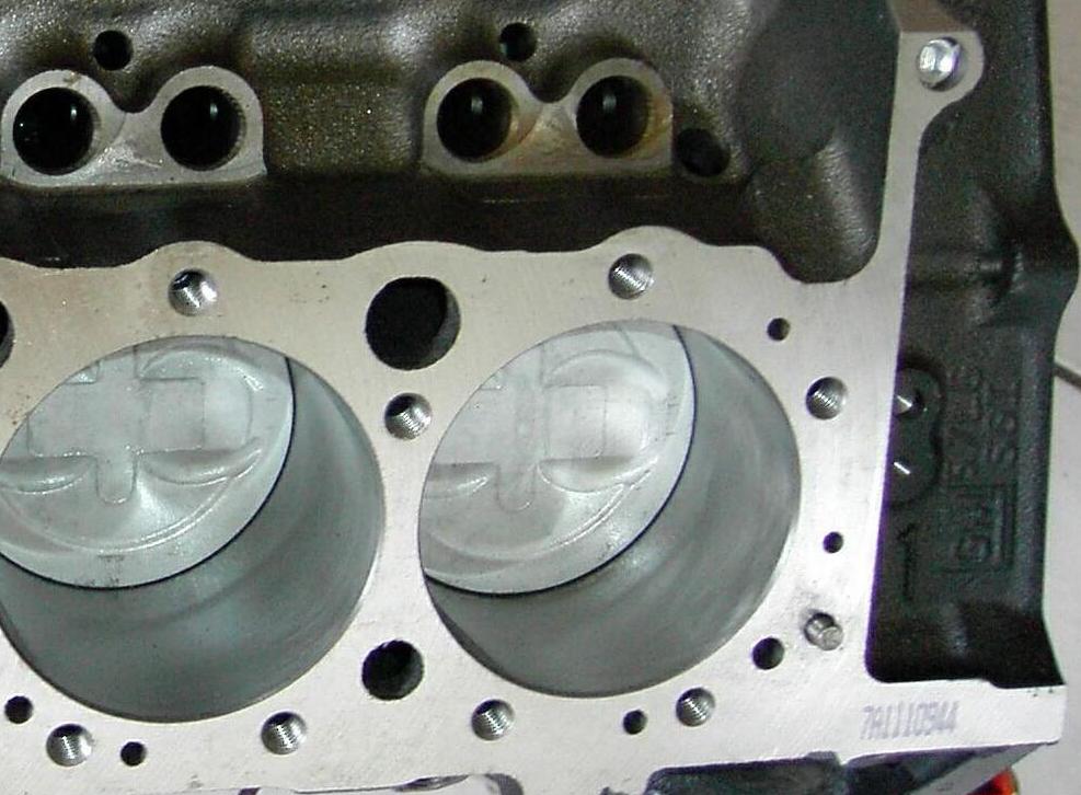

Here is a picture of the block before I painted in Midnight Blue
Attached Thumbnails Engine build based on partial block # 12556121-image032a.jpg
