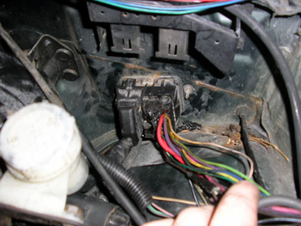

How do you remove this?
How do you get this bug Hunk of junk connector out of the firewall????

If that's the primary bulkhead, it's bolted in from the driver compartment.

7mm or 8mm bolt in the center pull out the plug. then the female end is helf in by ears? with bolts atching to the firewall I belive

when i removed mine, i had a hell of a time with 2 ppl. It's bolted, or riveted, mine was riveted on. I knocked them out with a punch. Then it was clipped, so you had to undo the clips, i broke mine since it was never going back into the car.

every one that I've pulled out was held in by a 1/4 or 5/16 bolt in the center from the engine side of the firewall. Loosed it (it wont come all the way out) and then pull the plug out.
