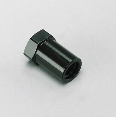

Inside of each lock should be a set screw that gets snugged down against the top of the rocker stud. I use a wrench on both the hex and the set screw, once the lash is set run the set screw down, then turn both (tighter) just a smidge. That will lock them in place. Don't go overboard, just a smidge tighter will hold them.

Attached is a pic of a polylock. This one is a CompCams unit, but unless for use with a studgirdle they are all much the same.
The hex on the one end it is the top of the lock. Inside of that end should be a set screw. Need to use an Allen style wrench to rotate the set screw.
Before putting the locks on run the set screw out until it is flush with the top of the hex end of the lock. Place the lock over the stud hex end up and screw it down by hand. Stop as soon as there is no longer any push rod play.
Now adjust the valves one at a time. Once a valve is adjusted prevent the polylock from moving by holding the hex end in place with the wrench. Using the Allen wrench run the set screw down into the lock until it is in contact with the top of the stud.
Once touching turn both the hex wrench and the Allen wrench a smidge tighter. Done. Move to the next valve.
See how that works out.
My preference for tools is an offset box for the poly hex, and a T-handle Allen for the set screw.
RBob.

rrob, i got about half of that. the Hex is the 9/16 part at the top, now there is no spot on the top of the hex for an allen key, now inside of the poylock down the threaded part when i look inside there is a gold piece at the end, dont recall if i could put a allen key in there or not.
what do you mean run the set screw until it is flush with the hex? you mean turn until its all the way to the top up by the hex, which i think they are, they are at the end.
what about "unloosening" the inside (if its possible) until it comes almost to the end at the opening part where it goes into the stud. that way while im tightening the roller rocker til there is no play in the pushrod, it will be at the right point inside the polylock, tighten them. but i dont get how you said use allen key AND wrench, because if its on the inside i cant tighten it.

The main body of the poly lock is what adjusts the valve and the small grub screw inside is what locks it in place to keep it adjusted. Use the lock to adjust the valve. When the lifter is on the base circle tighten it to zero lash then go 1/4- 1/2 a turn. Then tighten down the grub screw.

oh, i have i do the 1/2 turn, put an allen key inside and tighten it until its snug, or til i cant turn it no more?

this is how i did it, and played with pushrods til they didnt move, then made 1/2 turn on all
now when i go back to the car, i put allen key wrench inside middle of hex, and turn til it is snug and cant tighten anymore?

well i re-did the whole valve lash thing, everytime i did 1/2 i would tighten the allen key, then do 1/8th turn with wrench and allen key.
NOW, after i tightened all of them, i went around and checked for play, none of them would wiggle up and down at all, but they would move side to side about 1cm, so i tightened less then 1/8th and they all were tight again.

I'm really not sure what you're doing. When you adjust valves with the poly-locks you first start with zero lash (can't wiggle the pushrod but it's not being compressed into the lifter yet). Tighten the nut 1/2 turn from there then tighten the center set screw. The set screw pushes down on the rocker stud and pulls the nut's threads tight against the rocker stud. After you've adjusted the rockers, you'll still be able to turn the pushrods because of how the hydraulic lifters are designed. Don't go tightening them down again because they feel loose. That's just the lifter bleeding off pressure.
