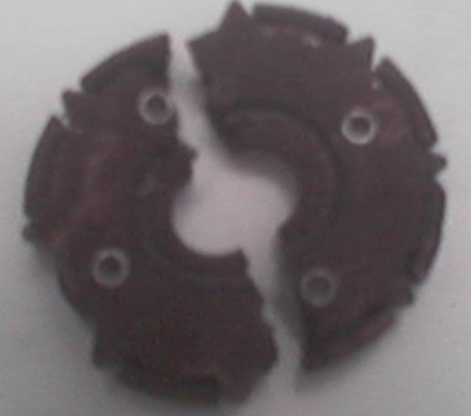

Well...my car started dying hard on me today. Definitely an ignition problem. Without warning, the entire engine would die as though I keyed off. No other electrical system appears to be experiencing any problems. It got really, really bad and I tracked it back to either the coil or distributor. I replaced the coil on a whim hoping things would get better, but nope. I then bought a new Ignition Control Module & Pick-Up Coil. Everything was going smoothly until I went to replace the old Pick-Up Coil. I pulled up on the magnet (timer core, trigger wheel...whatever you want to call it) and it shattered...The old Pick-Up Coil looked absolutely baked. The previous owner of this car let it redline [edit: "redline" on the temp gauge] about twice a day for a year or two and I guess it screwed up even the distributor electronics. The Pick-Up Coil plastic felt like a damp graham cracker.
This magnet looks like a part that I cannot purchase separately. If I cannot find one locally or pull it from the junkyard it looks like I'm set for a new distributor. Well...at least I've now found the source of my inexplicable code 43. Feed the ECM incorrect info and of course it's gonna go nuts from time to time...
Anyone know where I can find one?

Very nearly...The P/N you gave sits just underneath the magnetic trigger wheel. What I need is a metal disk ~1-13/16" in diameter and ~5/16" tall. It has what looks like eight poles spread around its circumference. There was also a copper shield around the entire assembly which was damaged as well. Do you have the number for that piece, also?
