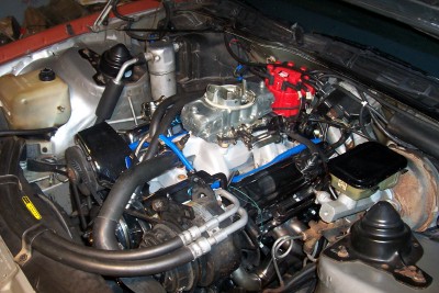

Originally posted by Confuzed1
OK, I don't know what intake you're running, but there is a large vacuum port at the rear of your carb - I use that for PCV only. For the brake booster, I run a intake very simular to a RPM air gap, and there's a plug for a vacuum fitting darn near underneath the secondary fuel bowl on my Demon carb on top of the rear runners.
I had to buy a "low profile" 90 degree vacuum fitting to hook the brakes up to. What I further found out, that even with this special fitting, I still didn't have enough room and the carb would not sit flat on the intake (bottom of the bowl hit the fitting), so I used a 1/2" carb spacer to bring the carb up out of the way, and the problem was solved. Two separate fittings for brakes and PCV - that's what you want. If you tee off your brake booster with the PCV, your booster will NOT have enough vacuum left to operate properly - or at least mine didn't. Hope that helps!!
The stock port is a lot smaller than the brake booster line. Looks like I need to change to an aluminum spacer or run the PVC from the manifold. I’d like to keep the brake booster in the same location as stock though.
Where do you take the vacuum advance and cruise/accessory vacuum on your set up? Mine is off of the manifold location.
Sorry I didn't post my set up, I posted something similar on another thread and thought I did it here. Here's some pics but they don't show the Holly carb very well.

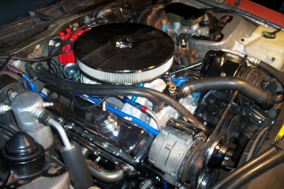

Originally posted by jstoltz
this question go to Confuzed1, I am also running the air gap intake and a 4150 (4777) still having problems with mine did you but the edelbrock low pro fitting or another. The tech from edelbrock said it was specifically designed for this purpose. I haven't even had time to try it yet. also if you are running a 1/2 spacer what size air cleaner are you using? thanks in advance. do by any chance have a pic. also by anychance anybody on here have a wiring harness mine is missing the tranny plug and I already set it up for vacuum lock up.
I run a Demon carb, but it's pretty much the same. I bought the Edelbrock low profile fitting but still had to add a 1/2 inch wood spacer. "Specifically designed for this purpose".....Edelbrock's full of it though, cause it's not "Low Profile" enough to use with a regular gasket only.
So far as my air cleaner, it's a cheapie that does the job, but ain't fancy...part #720-4339 14'' Diameter / 2-1/4'' High Low Rider Air Cleaner - Jeg's. I'll see what pics I have.
