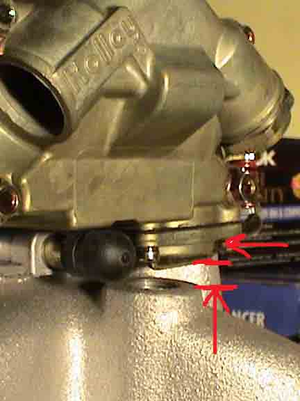

The other pic, you can see the rear vac port and clearance issue common with many.
