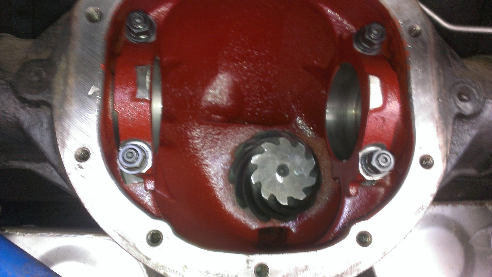

I did mine right after coming out of the shot blast cabinet at the machine shop and I baked it for the required time and temp. Of course it was clean as a whistle before I painted it and I had smoothed out the sharp casting and radiused all drain holes. Long process but it’s a simple piece of mind.

Glyptal?
Nice job whatever it is.

Yes

You can use whatever you’d like, have you ever even done any of the processes to an engine?

More important than using Glyptal (I use it a TON)...
Is proper cleaning and surface-prep.
Roughen-up the surfaces, and CLEAN, CLEAN, CLEAN!!!
You DO NOT want this stuff flaking-off!

Excellent use of the stuff.
