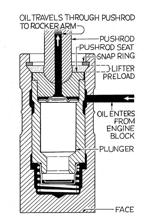

Check this out.
I backed off all the rockers until there was decent lash (loud clicking). probably about .040".
Fired car up until it got warm. turned polylocks by hand until almost all lash was removed.
Car idles steady, vacume is 15hg, no skips, no breakdown when you hold the throttle.
5 of the 8 rockers don't squirt oil, even though I checked ALL of them and the pushrods and they are not clogged.
When the lifter is pumped up, it is ROCK SOLID. Normally, in my experience, hydraulic lifters are a little spongy and you can push down ont he pushrod. These are SOLID, no give. Which is why when you attempt to adjust lash, it doesnt push on the plunger, it opens the valve.

After doing some online investigating, it seems to be the difference in the inner diameter of the lifter and the outer diameter of the plunger that sets the "bleed down" rate. There is no "hole" to perform the function as I previously thought.
If the clearance gets closed up by varnish etc, the bleed down rate decreases and the lifter can go solid.
With the lifter at the bottom of the bore (on the base circle of the cam) the oil pressure is directed into the lifter by a port in the block that lines up with the lifter at that point. Oil pressure extends the plunger to remove the lash in the system.
The lifter is forced upwards by the cam lobe and the fluid hole is then blocked. This causes high pressure to build under the plunger in the spring cavity to push the valve open.
At this point the lifter is slowly loosing volume by bleed down.
As the lifter drops to the base circle again it is refilled for the next cycle.
Makes sense that if beed down does not occur, then the lifter is just solid.
Excessive bleed down will cause the vavle to close early due to lack of volume holding the lifter extended.
With only an 0.020-0.060 preload recommended there is not really that much room for improper bleed rate.
Lots of good reading out there. Never gave them much thought until now.
HTH

This went on for several weeks and adjusted hot, cold, on and off with no change in how they reacted. Over tightened, set real loose. Had me so PO'd that I couldn't get them to work, Thought I had something major wrong and pulled the heads.
I'm chalking it up to varnish or other contaminates closing the bleed down clearances. Bought new Comps R's so I don't have to worry about it in the future (hopefully)

This is all very interesting, but regardless of whether they were soaked overnight, a fortnight, or 20 years, they cannot possibly have more oil under the plunger than if you were to set the lash by running them hot. When backing off a lifter to the zero lash position, they fill with oil - Period. Unless the plunger bore in the lifter body has some taper, they should bleed off at the same rate along the full plunger travel distance.
Either way my new lifters are not bleeding down, so either all 16 are defective, or Crane is correct.
I guess I can call comp and ask them what they think.

I called comp. They said they've had some lifters do that, and they've actually seenit happen. Plunger stuck al the way up. He said try lightly tapping the rocker with a rubber mallot on the pushrod side at lift, and if that doesn't work RMA them.
Unfortunately, I'm using "Summit" lifters, not comp or crane, so I'm on the phone with summit trying to figure out if I can rma them or not.

Backing off the rockers seemed to solve the issue.

It ended up being tight valves, because of lifter failure/problems. Although I adjusted valve lash a million times, it was dismissed. I checked it again after yzinger1,
and that is when I realized the problem.

Originally Posted by anesthes
Mine was faulty lifters. They would pump up and open the valve. Never pump down.
-- Joe

I dont get any oil squriting from the pushrods at idle at all
One wrinkle about the lifters in my motor (please excuse the log explanation): I've got a 70's era 010 hi nickle content 4-bolt 2 pc RMS block. And it has roller lifters. EXCEPT the guy who built my engine did something funny with the roller lifters. What he used fr lifters was standard non-GM replacement lifters for a mid-90's 3.1L v6 motor with the standard 2-hole retainer to keep them from rotating and the standard "spider" to keep them in the bores. He did not use the retro-fit lifters, probably trying to save $$ would be my guess. Suspecting that may be my problem, I've got a new set of GM roller lifters for a 350 on hand. I got to comparing the 350 lifters to a "spare" v6 lifter like he put in my motor. First off, the v6 lifter is 0.350 inches shorter in overall length than the 350 lifter. Diameter, both across the flats and around the circumference is the same. But, the small oiling hole on the side of the lifter is also at a different location - the 350 lifters have the hole 0.259 inches higher up the lifter body than the v6 lifters. That oiling hole is also at least double the diameter bigger on the 350 lifter. And the oil grooves on the lifter body start 1/16th inch higher on the body and are roughly 1.5 times taller than the groove on the v6 lifters.
Is there any way these v6 lifters can be correct in this motor? I doubt the standard GM 350 rollers are either otherwise there would be no need for the retro-fit rollers to exist, right? Is there any chance the spring rate on my Sportsman II heads is such that the lifters are not working right? I can adjust the valve lash with it runnng by backing off till they click and then going 1/4 to 1/3 turn past the point where they stop. I also use a scrwedriver touching the polylocks to feel when they are clicking, seems a lot more sure and noticeable than strictly just listening for the clatter.
If necessary, I'll move this to a different post, but I fear it may be related to Joe's discovery about his lifters....
Don't know if it matters or not, but I've got a Comp custom roller, small base circle cam. Cam specs: 218/224 duration @ .050, 112 LSA, .495I/.502E lift with 1.5 RRs but he put 1.6 RRs on the intake for a lift of .520 or so there.
