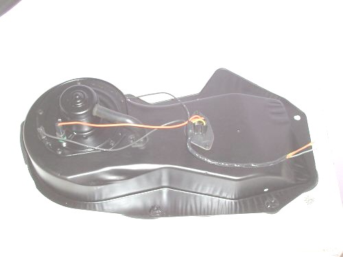

I havent had AC in the car for the last couple of years...it did work fine but when I did all the other work on the engine I took off the AC motor and lines and was left with what you see...yeah sometimes I wish I had AC but oh well.....I just want to remove whats left....the delete box I got off EBAY comes complete with working motor and resistor....so I wont have a problem with the fan size.....

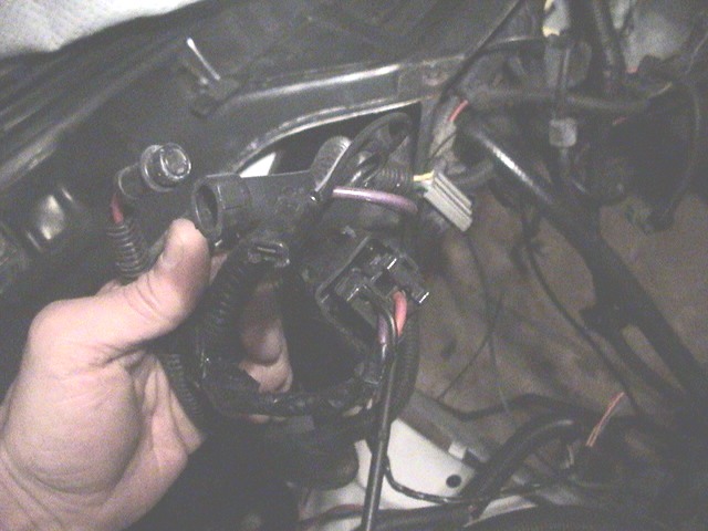

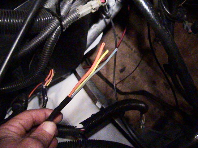

Need help wiring it!?
yeah Im bring back my own thread back from the dead....I finally got around to taking out the old and putting in the new....
and I havent a clue what to wire to where...anyone help me out?
heres the wires I have coming off the new one..only 3
Old Sep 25, 2006 | 08:55 PM
Wishmaster's87IROC's Avatar
Joined: Feb 2000
Posts: 2,850
From: Winston salem, NC
Car: 1987 1SICIROC.....1999 TransAm
Engine: 385 HSR.....LS1
Transmission: 700R4 with Midwest 3400 2.4str...M6
Axle/Gears: SLP Zexel Posi unit 3.42's...3.73's
and heres the cluster f*** of wires I have that where connected to the old AC/heater box...
what do I cut and wire to the 3 new wires
from looking at it..it looks like I dont need most of the old wires anymore...
thanks
