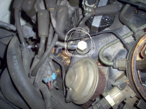

Is this a hose for a vacuum and if not what does it do? I was playing around just to see if anything popped out at me and was wiggling wires just to see and that hose when it connects to the manifold was really loose. I tried to pull it off and it came off really easy and the underside of it was ripped and not really closed at all. Just wondering if this could of caused my problem or what kind of problem this would cause if any at all.
Old Feb 17, 2006 | 11:02 AM
thirdgen88's Avatar
Joined: Apr 2003
Posts: 1,751
From: Bonner Springs, KS
Car: 1995 Corvette
Transmission: 6 spd Manual
Axle/Gears: Dana 44, 3:45:1
Yeah, its a vacuum hose.. It supplies vacuum to the cruise control and HVAC system.
