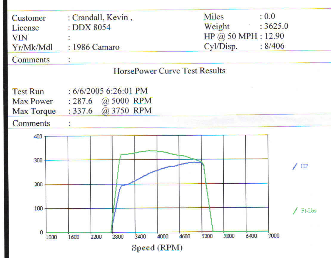

allright so if stay 10 or 9.8 i would be good? How much gain could be expected from just pistons alone? and yes i already have the rpm air gap intake. how about these pistons?
http://cgi.ebay.com/ebaymotors/Speed...QQcmdZViewItem
and here is a link to the dyno sheet
https://www.thirdgen.org/forums/atta...9&d=1119143380

Head gaskets, im not real sure what is on there but i know they arent specially thin ones..... they are just fel pros with steam holes.
As far as track testing no not really
My old setup same bottom end, only difference was stock 350 heads 64cc 1.94 1.50 valves, xe 268, performer rpm, stamped non roller rocker arms, performer 750 carb. I ran 13.5 with 1.8 60 foot times.
with all i added i figured i would feel alot more power. with more cam, better heads, better carb, roller tip rockers, only thing i know killed me was the performer eps intake but i dont see the intake holding it back that much.... you guys think just putting the rpm air gap on would give me anything more... i already have it so what the hell
i got it down to 12.7 last night, swapped out the intake to a rpm air gap, 1 inch carb spacer, and 3.73 gears on an open diff cant find a 3 series posi for sale anywhere that isnt a gov loc. Car weighed in at 3280 with me in it (170-180). I think if i could get a better 60 foot and could launch it at a higher rpm i could get a 12.5 maybe.https://www.thirdgen.org/forums/atta...ht-12.7-et.jpg
