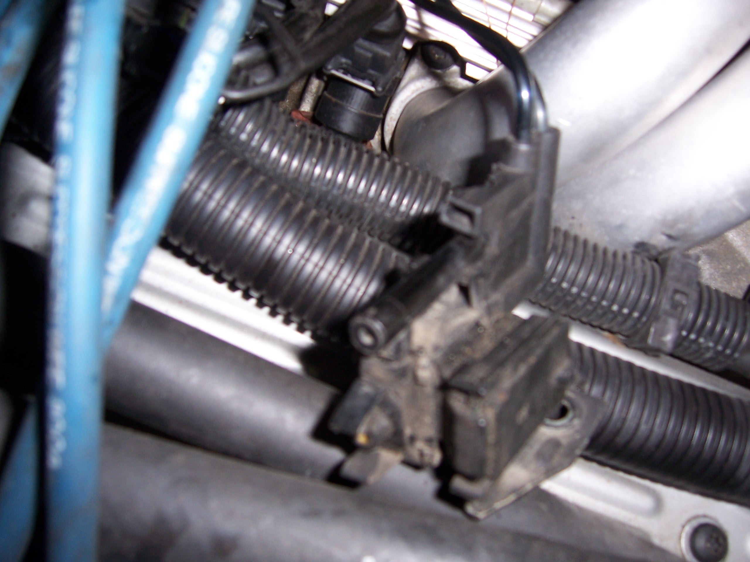

OK, now it wont even start at all. even after sitting for a day or two. i got some pictures of some kind of connector for a sensor or something, but its not connected to anything. its on the passenger side, very close to the distributor.

thats funny. i have that one end and nothing to connect it to ...you think im missing the other end to that...or maybe just something else with the wiring harness.

Looks like the EGR solenoid. Normally, it mounts under the coil. A malfunctioning EGR will make your car run crummy when in closed loop, and make it act like it is running rich, but should have no effect on a cold motor. Perhaps the coolant temp sensor (For ECM) is on its way out? Do you have a scanner that you can look and see?
