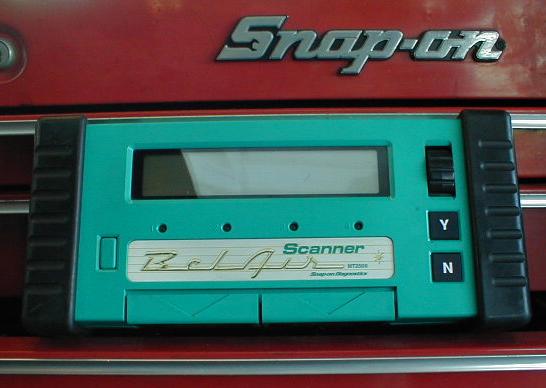

Commonly known as the "Red Brick", this is the 75th Anniversary Bel Air Edition, 1997 or 98. They also made a tool box that matches. Got a pretty good deal on it and I've been using it ever since. Even though a paper clip can give you codes, seeing the data stream is a more valuable tool.

The picture was a BMP, had to change it to a jpg.
Attached Thumbnails Who is using a scanner that actually works?-snap-scanner.jpg
