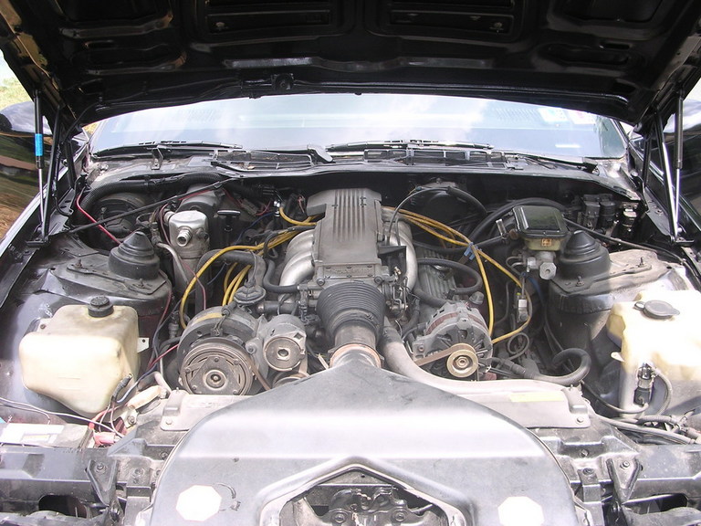

how to get a/c again-me018.jpgclick on this pic to enlarge. it shows what i have. so what DO i have?

Most of it is there, hoses are gone. Condensor still in front of the radiator?

It appears that at least the hose set is missing. That means a complete flush, evacuation, and charge after the missing components are replaced.
Looks like you might want to do something with the fusible link setup near the battery, too.

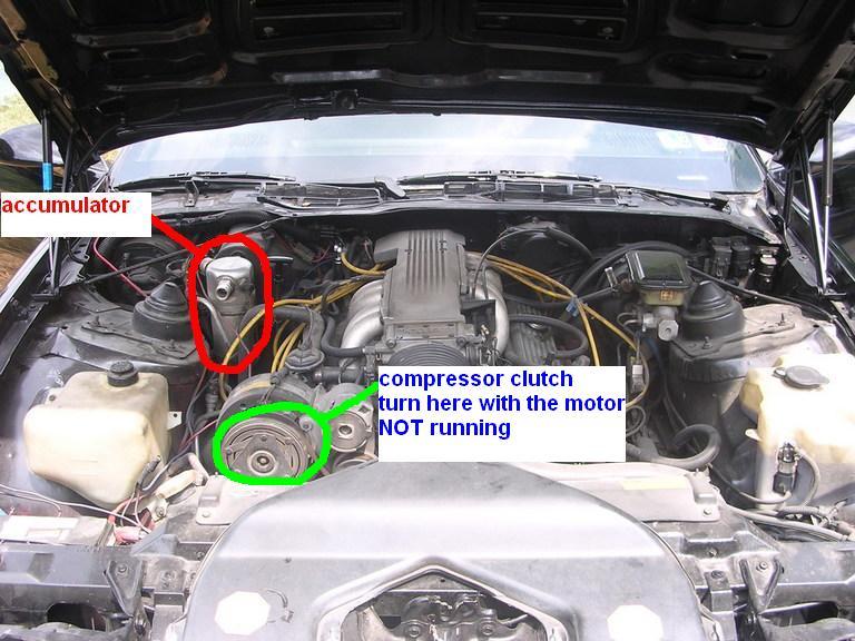

A/C systems hate moisture. 1 drop of water in it is enough to cause problems.
you will have to replace the accumulator (circled in red), it is designed to remove any moisture that wasn't gotten out during the evacuation, yours is bad.
there is a good possibility the compressor may bad just from being left open. some A/C lubricants absorb moisture just like brake fluid does, or something could have built a nest inside the compressor.
you can check to see if the compressor will turn by hand, with the key off & the motor not running grab the compressor clutch (circled in green) & give it a few full turns, it doesn't matter which way you turn it, it should turn pretty easily. if it locks up or doesn't turn it needs to be replaced. be aware just because it turns ok doesn't mean its good.
not knowing the history or why the hoses are gone, if it was mine i would go a head & replace the compressor, if it is bad & you don't replace it with the accumulator & orifice tube, you will probably have to buy another new accumulator & orifice to have a warranty on the new compressor.
