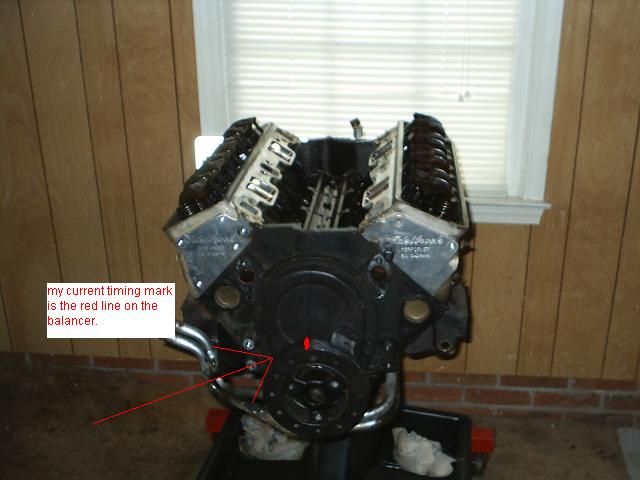

it would seem that even with the dist off a tooth, and the dist twisted to compensate for this, and the engine runs good, that the timing mark should at least be "around" the same place...just needs to be fine tuned. i might be thinking to hard on this. but when i check the timing on my engine, with the vac advance unpugged, the timing mark for #1 to get the engine to fire is not visible from the drivers side of the engine compartment. ill post a pic of the to show where it is.
i dont quite understand how this engine would run (TPI) before at the correct mark and run at a different mark without any changes to the lower end. im sorry to post jack this just seems like the crowd to ask
the only thing i can think of is a spun balancer and if i did spin it what would this do to my engine and is there a way to check to see if it did spin???
thank you

Your red line is where my base timing is set right now at idle with EST (tan w/blk stripe) unhooked, and my engine runs good.
So if I move the distributor 1 tooth it should bring my timing mark back to the gauge?

i did some calling around and it seems the common answer is that i/we spun our balancer. even if we are off by a tooth on the dist it shouldnt have that drastic of an effect on where the timing mark will be, because our engines start and run good/ or in my case did run good.
