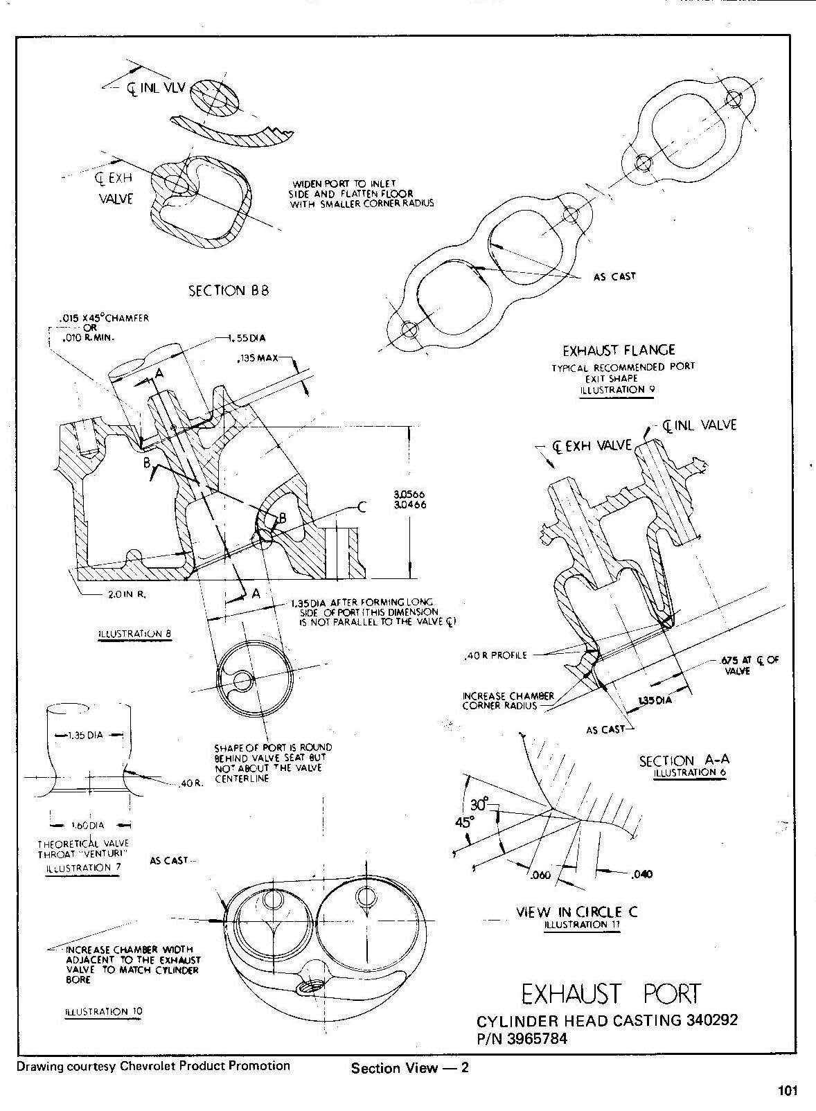

Well, now that the harsh comments are done, this combo is looking better then your last one
Which parts are on hand, and which are "to buy"?
I'd go with steel rockers, and pocket the $ difference from the AL ones.
That's just me though.
I'd also rather see long tube headers. Assuming you use those (68470's? and the recommended y-pipe?) Make sure you chop the y-pipe at the 2.5" neck down, and replace it with a 3" bend.
You've been busy porting the crap out of those heads right? (RIGHT?)
Look into a shift kit, or corvette boost servo. I know nothing about that stuff, but those are buzzwords that sounds fast, that you might want
Those heads probably aren't condusive to low lift flow, and probably aren't great for anti reversion (camminess). Backcut valves, a good 3 angle valve job, careful port work, biasing, chamfered intake valve face, and obviously good bowl work, will work wonders.
What brand of nitrous kit do you have? All the fixins on that?
Sounds like 400HP shouldn't be too hard to hit.

All parts listed are on hand. If I were to build it from scratch with nothing to start with, I would do a few things differently, but these are the things that I could get for free by parting out that drag car that I never should have bought. Remember the "so I bought this engine" post?
The system is an NX systen with a 25 lb bottle and a plate system. I think that I'm going to put a progressive shot to it. The engine is actually built and waiting to be dropped in barring a change of heart on the heads at the last second.
And I try not to be rude but I hate it when people chime in with retarded posts and have nothing but stupidity to inject into someones learning process. And I know I'm a little chubby, but my wife loves it!
Thanks for the comments.
The headers are shortys because the car is lowered 2 inches and the y-pyipe is custom and it is a 3" outlet to the cat (which will become a hollow pipe) and a 3" catback with a magnaflow muffler.

Well, if it's all built and ready to go, then it's a little late for suggestions right? Fire it up and find out how well it runs. It bugs ME to see continuous posts about "what will it run?" from people, then they never take it to the strip and repost in that thread to set people straight. I like to read how fast it ran later!
25lb bottle? Wowza, that'll do the job alright.
Was any work done to these 292 heads? I forget, I remember you got them off ebay right? And they said they were ported, but the pictures made them look like they were hauled out of a mudpit or something, and looked stock..?

The heads were worked over with a good valve job (according to my guy, one of the better jobs he's seen.) They had some porting done to the runners, but he says not to polish the bowls because something about the texture made for good combustion and that is why "turbo" is stamped on the side. The heads are virgin (according to him) with a little surface rust from sitting up for a while.
Let me correct myself... The shortblock and oil pan are assembled. The heads are still off of the motor because they might get sold to a buddy of mine that can use them on his '69 camaro in stock class. If he doesn't get to me with the dough today, they're going on tomorrow and going in the engine bay.

Anyway, yea, ok, those heads should do just fine. They are better used on a car that actually "needs" them to run in a class, but they'll work peachy for ya. I forget what supvisor42 runs, but I know it's something old like that.
Well, about the rockers then, AL rockers do fatigue, and wear out, compared to steel ones. If possible, i'd see if I could trade/exchange those for steel ones. But anyway, just make sure you pop a valve cover every oil change or so, and make sure nothing is pooched.
I prefer the performer RPM (air gap) over the weiand stealth, but I think its a pretty close race, almost just brand loyalty.
If you can get some sticky tires, i'm pulling for ya - high 12's. I'm eager to find out. Louisiana is far enough south that it's racing season all year round right? You guys don't get "winter" right?

oh, I was thinking high 12's NA. You can go up to higher jets in that N2O kit, so I think breaking into the 11's won't be a problem.

..which mine didn't. He's got the "good" '69 heads, not the 67-68 ones I did so much work to
.Systalis: are you going to run a serpantine setup? If so good luck with that upper right bolt hole in the D/S head. If you need a workaround give me a holler. Mine's still holding up.

Yeah I was hoping to use the same setup from the LO3. Why? Whats the problem.
I know nothing about swapping an engine. I have someone helping me that has done this hundreds of times and he also runs a thirdgen. His is a trailer Queen, though.
Do you think the head/cam combo looks good?

The roller lifters will need a lot of force to keep them on the lobe. Ever heard of a rev kit?
Figure out if you're going to definately use the 292's then we can work on making everything fit them.
P.S. you can really crank the timing on them unlike the newer "sheetmetal" heads.

The upper right mounting boss location on the d/s head was moved outward about 3/8" on the gen 2 (roller engines) heads. Only hole they moved. Everything else will line up perfectly.
The problem is the bolt in the P/S bracket is up inside the casting so you can't move the bolt hole sideways. They moved that boss outward for stability so you can't just leave the bolt out. I made a plate to tie the unused bolt hole on the side of the P/S bracket (casting) to the exhaust stud.
I have porting blueprints for the 292s if you need them.

Yeah, hit me with them (porting blueprints.) I could use all the help I can get. Without having the heads in my hand and my head under my hood, I don't exactly understand the plate thind with thew bolt hole, but I should be bolting them up tomorrow so, I'll guess I'll find out soon enough.

Ahhhhhh. I see now. Most people say to ditch the 292's and get some vortecs. Are they really that outdated?

Here are the pics for porting them. They require a fraction of the porting that earlier heads require. Expand the pics full size to read.
