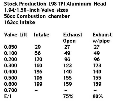

im not positive what kind of lift the your L98's can handle, but it's nowhere near .520 lift. If it were me, i'd keep it under .470 without some machine work and springs.
on a personal note, im running a lunati voodoo coming in at .468 I and .489 E. i've also got a pair of 416 casting heads I worked over. it's good for ~ 325hp, which IMO is just about right for a DD.

naw.. i need more power then that. i want something like 400-450... jsut personal.. anywho i was also told to look at vortec heads.. you got any specs on those... and by the way you should explain the whole chart to me.. i understand the combustion, and intake cc and stuff, but at the bottem.. you should explain that.

The bottom half is a chart. At the valve lift on the left, the different ports at the top flows the corresponding amount of air in CFM.
The percentage beow the exhaust port numbers are is the average percent that the exhaust flows in those conditions of the intake flow. Basically, it's exhaust flow divided by the intake flow.
Keep in mind, they aren't using real valvesprings for this test, which is why they are able to get to .600 lift. In the real world, you'll never get there without machine work.
