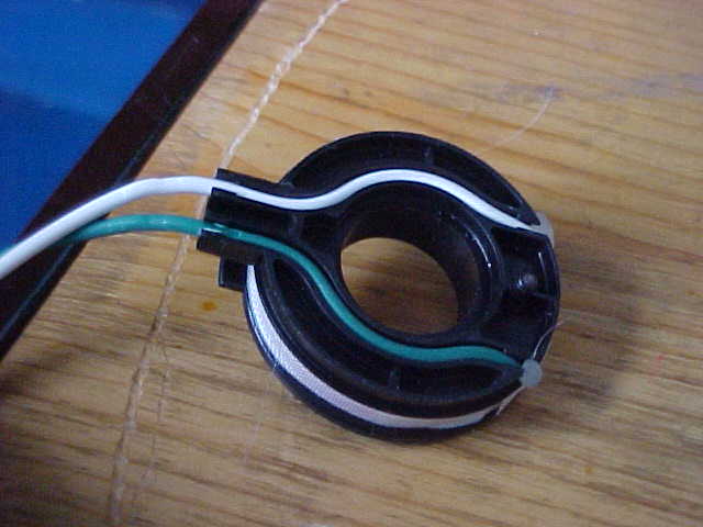

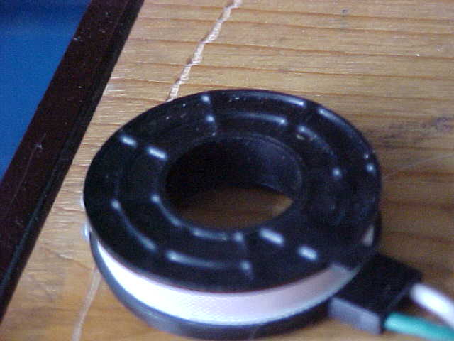

Ok, thanks, If you say so I will go with that, however, I have the new part, and unless i am missing something once the clip on top is removed, wouldnt that coil just lift up? Reason I am asking is you mentioned I have to remove the distributor to access the coil? Mine is accessible as soon as I take the distributor cover off, its right on top, I enclosed a picture of my part, you will see there is no area for a pin? just a round piece with a wire connector and the piece goes over the top and is secured with a C clip

Head out to the car and pull the cap and rotor off the distributor. Note the star wheel on the shaft. The coil fits below that piece.
Also pick up a new rubber O-ring. It goes onto the distributor housing right below the mounting flange. These always dry out and start leaking.
RBob.
