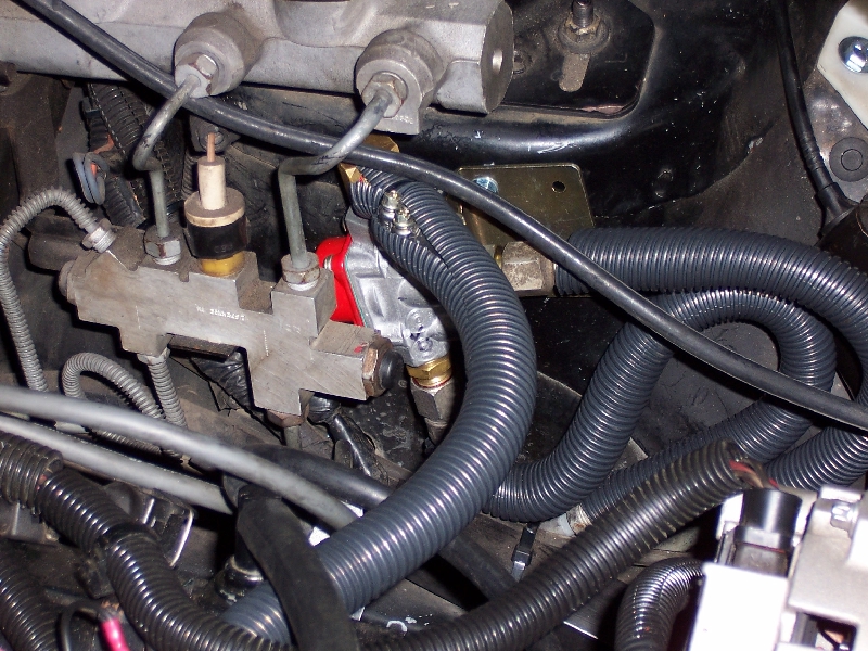

The bypass regulators are a little pricey but worth it. I've been using JEG's #793-30-900 on my formerly TPI car with a Q-jet with great success.
All the other (non-bypass) regulators won't work so don't try to cheap-out.
