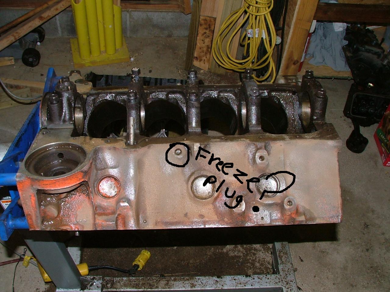

Both pics are of a 400 SBC, In the first pic there is a bolt which idk why its there or what its there for? The second pic is a picture of the opposite side which appears to be a small freeze plug? If so why would there be a bolt in the first one?

well i believe that would be a coolant drain plug in the top pic

Doh, can't believe I didn't think of that lol, thanks

and the same on the other side as both banks need to be drained seperatly

I'd throw in a petcock. You can find 'em in the parts stores where they have the brass fittings and whatnot, I think it's 1/8"NPT. That makes it easier to drain/flush later.

i put allen head plugs in my block and i couldnt get them off.. i just spun the wrench.. petcock it..

Alright, thanks for the info guys. But in the second picture that is not a bolt there, to me it looks like a smaller freeze plug? Should I leave that "plug" there or turn that into a petcock also? Thanks again for the info

i believe that is a threaded hole so it might be an allen screw that has been stripped out... but i would replace it with something wether it is a petcock or freezeplug or even a square head bolt in a rebuild why cheap out on a 95 cent piece\
