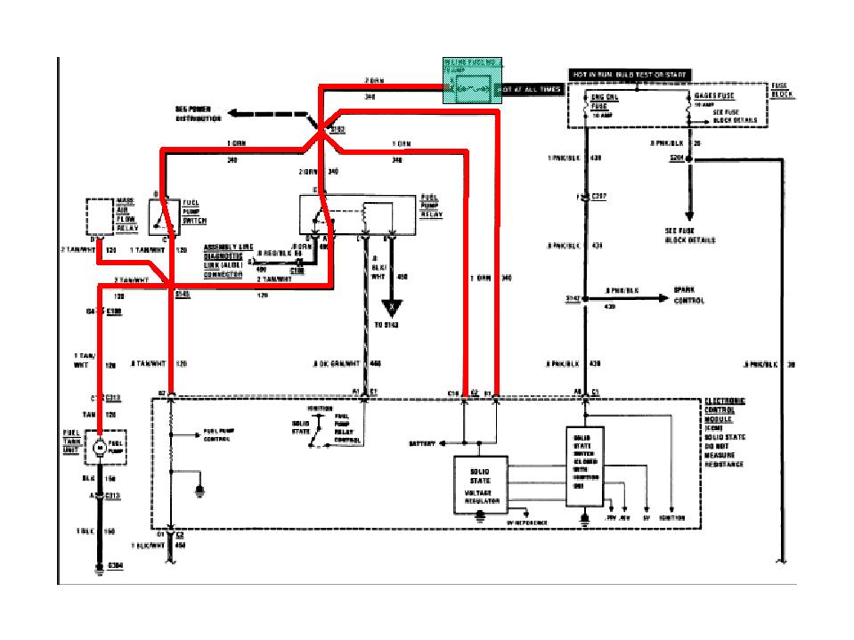

There are 2 problems with this car:
1. Low oil Pressure
2. Stalling
The fuel sender can't cause either one because it's not used to control anything, and the ECM doesn't receive a signal from it, it just sends a signal to the oil pressure gage as the sensor name implies, "sender."
The Fuel Pump Switch, and Fuel Pump Relay can only cause stalling conditionally because (they are switches; one mechanical, the other electronic,) that is if the relay is not energized by the ECM and the oil pressure goes below 4psi it will shutdown whatever is connected (MAF Relay & Fuel Pump) to it, and then power them up again once the oil pressure goes back up with rpms as when he, "press the gas" to keep it from dying.
I believe all thirdgens are wired per the attached diagram.
The "power at all times" 20 amp inline fuse power is routed through both the Fuel pump switch and the Fuel pump relay in parallel to the fuel pump so both would have to fail together for the fuel pump to shutdown.
