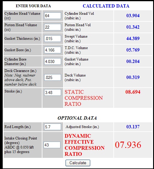

so i am building a 350 and trying to figure on my CR it should be around 8.23:1 with 22cc dished pistons and 64 cc 062 heads... running a .015 head gasket with stock length connecting rods and the XR270HR-10.. Now when i calculate the DCR i get about 7.52:1 is that to low? i used 43 IVC as comp measured thiers at .006 instead of .050 like my calculator.
and any of you blown guys with 10psi my DCR comes to 12.64:1 is that to high?
thanks

I think 7.52 is a tad low, but with a blower you're just fine.
.006" IVC is a better spec to use IMHO.
I use this one
http://kb-silvolite.com/calc.php?action=comp
and just use the IVC angle at .006" (as 43? ) instead of one at .050" and then add 15*.
I must have used different numbers than you did..?

okay i had the IVC wrong the cam is 61 close not 43 i tried to adjust for the different measurments with that calculator i get a static of 8.5 which is better for me but it still wants the .050 measurment not the .006 that comp gives... any way to accurately convert them?
i see now didnt get your attachment
my bore is standard not oversized
and i have gone through so many calculations at this point my math is very iffy

It asks for .050" + 15*, which is supposed to represent .006" or thereabouts. Since the intake valve needs to be completely closed before it completely stops flowing. I think .050" is usually easier to get so they give you that cheeseball 15* guesstimate thing.
I skip the middleman and just use the one comp gives, 61*. 61* makes more sense than 43*, my cam is in that ballpark of size and is about 62* IIRC.
