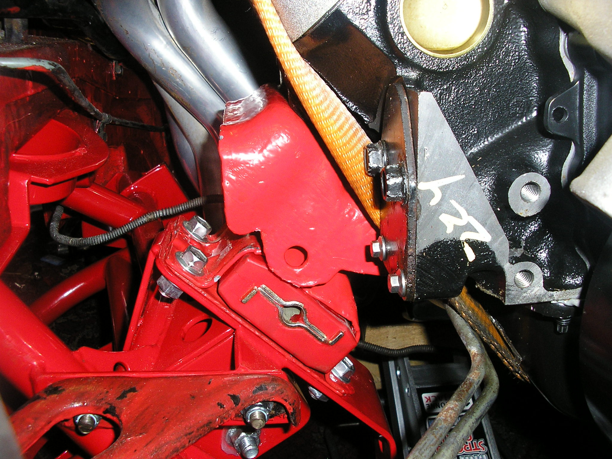

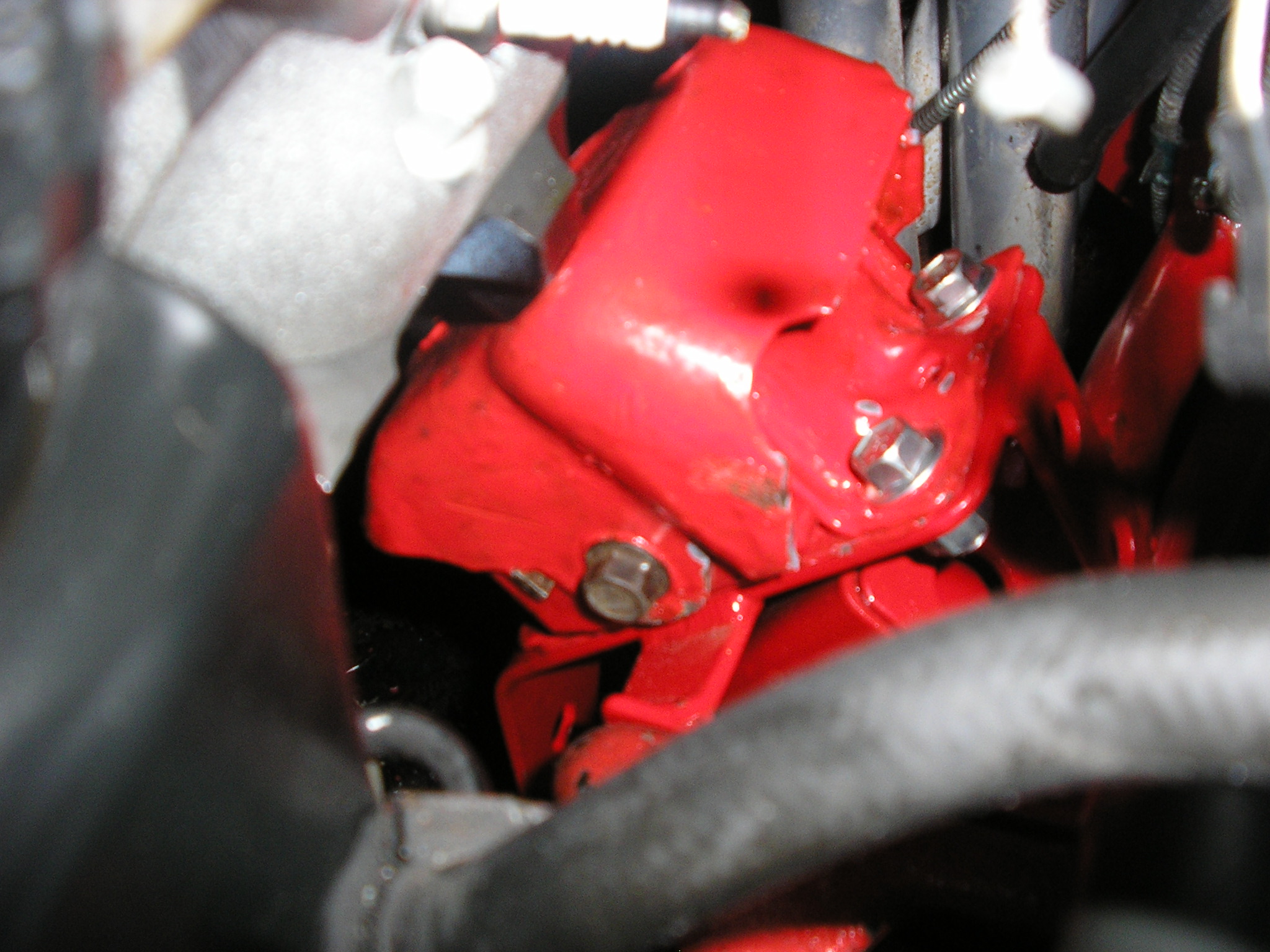

I'm installing my new ZZ4 crate engine at the moment and am finding it difficult to line up the engine and box, the locating dowels seem to be 5-10mm out.
Are my engine mounts installed in the correct orientation? It's been a while since I took the L98 out the car and I can't remember which way the engine mount tabs are supposed to go.
Can you guys take a look at the pictures and give me some advise?
Many thanks,
Gordon

Drivers Side Picture
Attached Thumbnails Are my engine mounts on the right way around?? Difficulty lining up engine/tranny.-drivers-side-engine-mount14.04.2007

Passenger side:-
Attached Thumbnails Are my engine mounts on the right way around?? Difficulty lining up engine/tranny.-passenger-side-engine-mount14.04.2007

Re: Are my engine mounts on the right way around?? Difficulty lining up engine/tranny
Flip your bushings. The metal coming out of the bushings are backwards.
ViperKiller:- Many thanks man! You were entirely correct, thanks for the assistance.
For the benefit of any others who end up searching because of a similar problem I'll post some correct pics below.
Again Vipklr - many thanks buddy!

Correct orientation of passenger side engine mount metal tabs:-
Attached Thumbnails Are my engine mounts on the right way around?? Difficulty lining up engine/tranny.-drivers-side-mount-correct

Correct orientation of driver side engine mount metal tabs:-
Attached Thumbnails Are my engine mounts on the right way around?? Difficulty lining up engine/tranny.-passenger-side-mount-correct

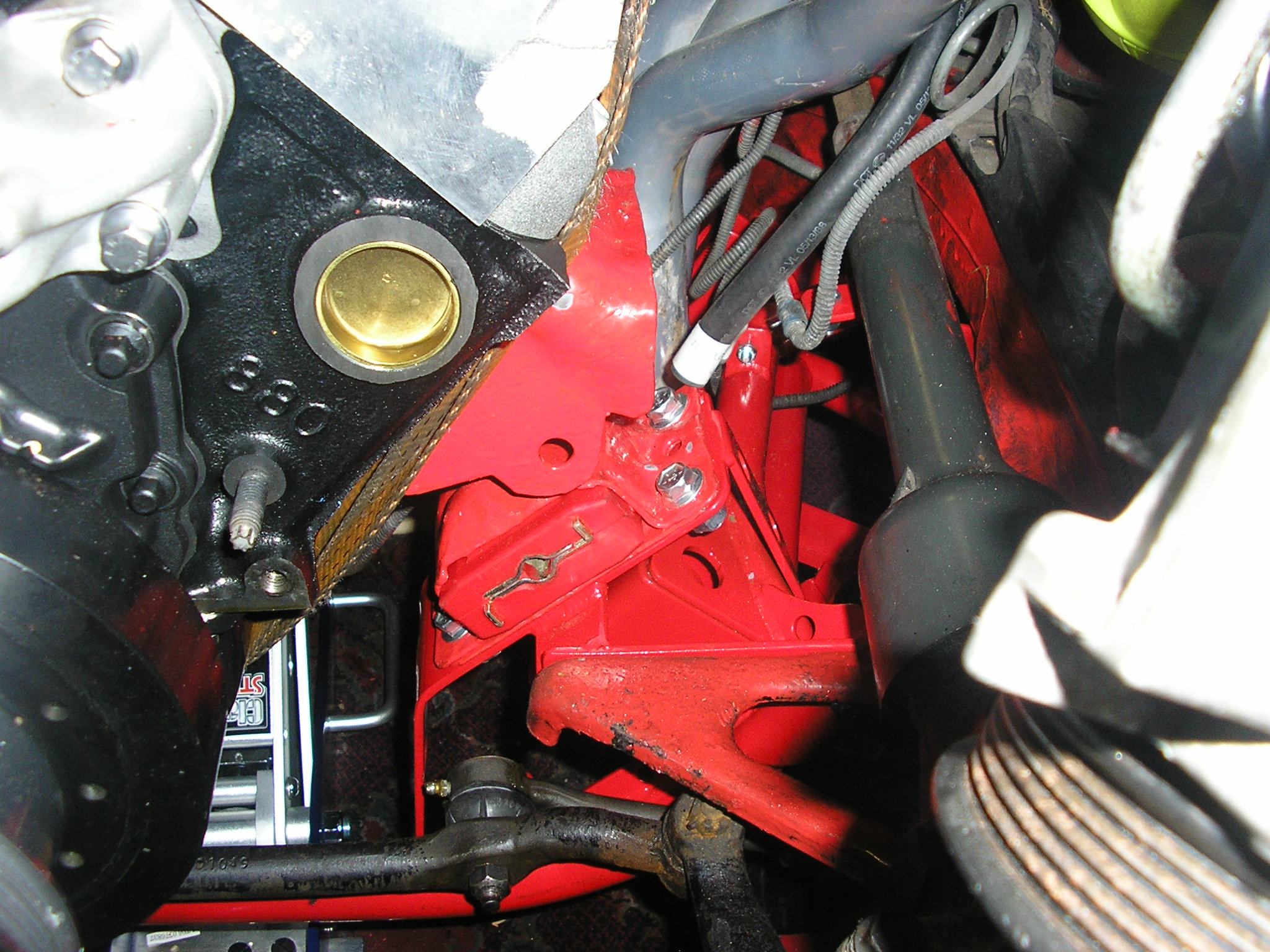

Here's a better pic with the passenger side connected/bolted:-
Attached Thumbnails Are my engine mounts on the right way around?? Difficulty lining up engine/tranny.-passengers-side-correct-14.04.2007

Here's a pic with the drivers side connected/bolted:-
Attached Thumbnails Are my engine mounts on the right way around?? Difficulty lining up engine/tranny.-drivers-side-correct-14.04.2007
