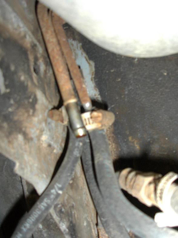

this is what i found when i looked under the gastank, not sure if this tube is supposed to be open like this doesnt really look like it is.

Looks like you're missing the plastic bell shaped vent. I don't see how that would cause your problem though.

thats what i thought. my only guess is that something got lodged in there. would my best option be to drop the tank and try to replace that?

Avoid dropping the tank unless absolutely necessary. I just dropped mine to replace my fuel pump over the weekend. I don't wish that job on anybody.
Try running air through that tube if you believe it to be plugged. All 4 lines coming out of the tank are solid and mounted directly to the top of the fuel pump assembly. You can't exactly just replace 1. The vent gets attached to a rubber line which then gets clamped to that pipe in your picture.
