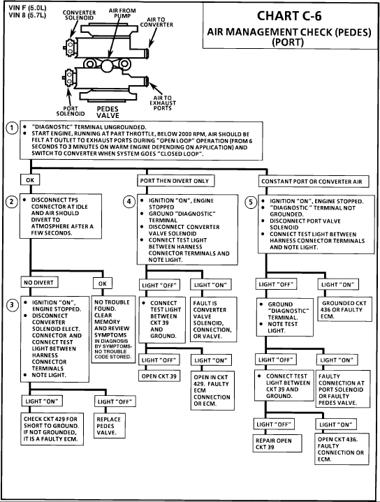

their are two solenoids in the air divert valve.
anyone know how you can test to see if they are working?
I didn't know if you have seen this chart posted by RGARCIA63:
