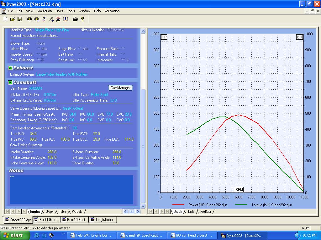

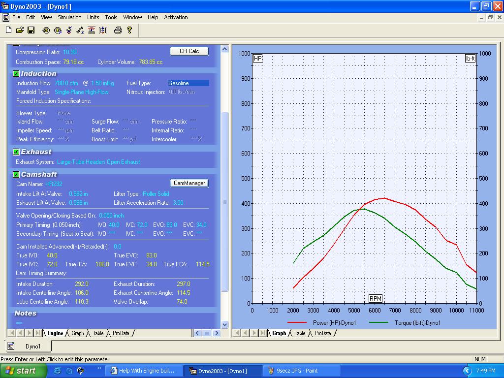

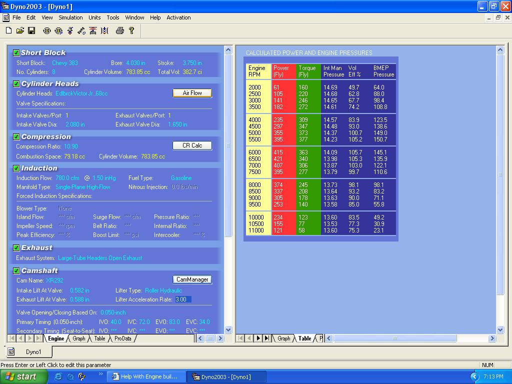

I just dont see how your will get 500 HP out of that... not saying your wrong sofa maybe you have some personal experience
but i plugged this stuff into DD just for an abouts

Re: Help With Engine build!
For one, an XR292 isn't a hydraulic roller.
Old Sep 15, 2007 | 06:26 PM

I will be honest, I've built many street motors but nothing this radical. Those power numbers seem low to me. But I am just going on power numbers I have seen from known combinations (i.e. magazine builds). I know super chevy built a 355 with the same heads and intake but with a little smaller cam (248 intake, 254 exhaust) and made 512 hp at 6300rpm (it was one of there danger mouse builds).
Yes, they're way low because DD assumes that a hydraulic cam starts to die off quickly above 6000 RPM. If he modelled it correctly as a solid roller it would be more accurate.
But looking at the low RPM numbers, you can see what will happen with a 3500 converter. You'll have something that an LO3 can spank off the line.

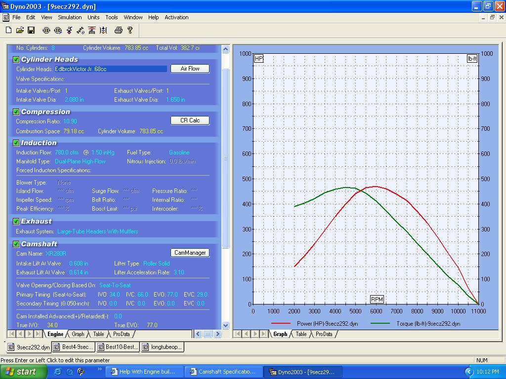

actually i set it up with the solid roller but changed it hydrualic to see if it would change the lifter accel rate which it didnt...

It's not the lifter acceleration rate that's the problem. What were the numbers like as a solid roller?
You're using lash-to-lash timing events as .050.

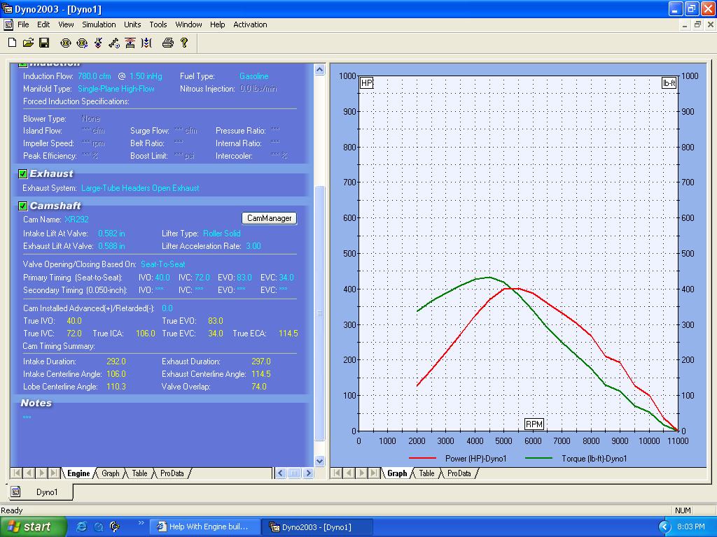

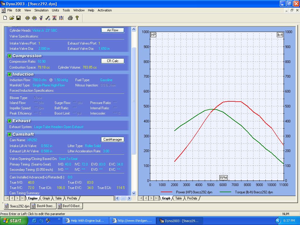

yeah you were right ape
here it is with the correct seat-seat timing form comp well .015
still not close to 500hp though

Something just doesn't seem right with those charts?! With a 215cc head, big cam and single plane intake it should be makeing peak power way higher than 5500rpm. Unless I'm reading those wrong. Aboult the 3500 stall, going with those charts wouldn't a 3500 stall work best? It would put me right at the start of the torque curve where it is best to launch. Torque gets you out of the hole, and horsepower carries you down the track, does it not? With the higher stall it will almost put me right at the end of the torque curve would it not? I am new to building a car from ground up, so please enlighten me if I'm wrong!!
well give me your flow#'s so i can compare and re do the sim
Flow #'s are:
intake/exhaust
0.100 67/64
0.200 123/111
0.300 173/145
0.400 219/180
0.500 255/198
0.600 275/206
0.700 284/210
Old Sep 15, 2007 | 07:38 PM

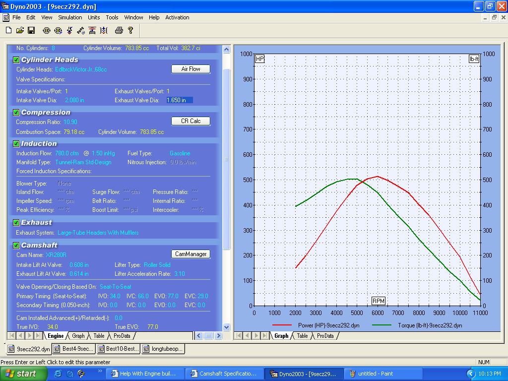

okay i have changed the flow # those are much higher than some of the other # i have for those heads... have you had anywork done to them when did you get them?

I got the heads about 3 weeks ago from Summit. i got the flow numbers off of AFR's website actually as they were doing a comparison to say how much better there heads are that they claim they did there own flow bench testing on. So I am going to assume that they wouldn't give inflated flow #'s about a competitors head!!
i wouldnt think so either... those might be a little low if anything but deff 500hp...
DD2003 has a few bugs and isnt the end all... it is sorta just a "semi" educated guess

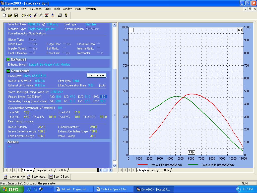

okay here it is with a 242 .050 / 250 .050 solid i dont have any specs for a solid roller that small it is also a .470 lift rule cam so i will make any adjustments you want
Ok here are the cam specs for the one I was telling you of:
grind # Xr280r solid roller
242* intake 248* exhaust with 0.570" lift intake and 0.576" exhaust with 1.5 rockers and a 110 LSA. Can you also test the custom grind cam I listed in the initial post or do you need the cam timing specs? And also try with 1.6 rockers for the tests? Wow, I almost sound like my wife with asking can you do this all the time!
Old Sep 15, 2007 | 09:06 PM
SpitotRs305's Avatar
Joined: Oct 2006
Posts: 1,974
Car: 91 RS
Engine: 350 vortec
Axle/Gears: not the best not the worst
okay here it is with the XR280R with 1.5s and 1.6s
Attached Thumbnails Help With Engine build!-9secsolid.jpg   Help With Engine build!-9secz.jpg

And One last thing, can you test the smaller cam with a performer rpm air gap and an hsr. I want to see what the power difference between the single pland and dual plane to the tunnel style injection. And that is the last thing I will bug you for!!! I thank you for all of this! I'm glad I joined this site, what an amazing amount of info!!
Old Sep 15, 2007 | 09:16 PM
Joined: Oct 2006
Posts: 1,974
Car: 91 RS
Engine: 350 vortec
okay air gap/ tunnel ram
Attached Thumbnails Help With Engine build!-dphf.jpg   Help With Engine build!-tunnel.jpg
